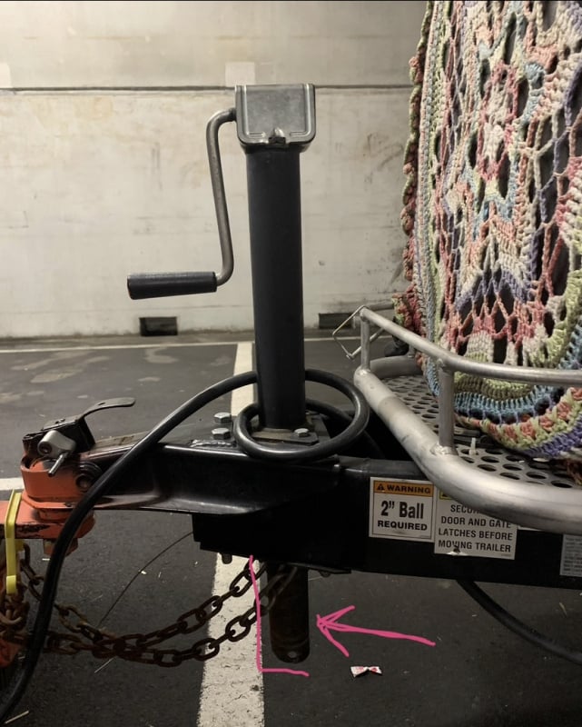

We had more tornadoes today so I just threw the camper onto the back of the car when I went to pick up Den from work and we went to IKEA to enjoy their garage and for dinner. Anyway, I made a mistake and forgot to remove the foot and I bent this pipey thing. Do you know if that bottom tube part can be replaced without replacing the whole trailer jack and also any idea what size it is? It looks like I can buy a full one from etrailer, but I don't know the size for sure. We have a 2" Curt trailer jack foot instead of a wheel on there so does that mean I would buy a 2 inch trailer jack if I have to replace the whole thing or 2 1/4? The size I am finding on etrailer is 2 1/4.

Edited to show you how bad the foot is bent. I don't have a close up of the jack pole damage. I think we are going to replace it with the Ultimate Jack. Doing research still but people seem to like it on here and I can pick it up at Tractor Supply.
You can replace the entire assembly with a 2-1/4 - It just bolts into placeTV:2019 Nissan Frontier PRO-4X With an Old Man Emu liftTrailer: 2019 T@B 320 Boondock with a Lock&Roll Coupler & Jack-e-upCustom fabricated metal bottom claddingCalifornia, USA
You're looking for a foot plate. Most folks use a captive pin with a wire bail to fasten it. That makes it easier to remove or swap out with a caster wheel as opposed to undoing a bolt. You can confirm the size you need by measuring the outside diameter of that bottom tube. If it's under 2", get a 2" foot plate.

Cherokee, thank you! 2 1/4" it will be! I appreciate you.

bjn2 it's more than the foot plate, the jack piece is misshapen now. I bought the Curt foot on Amazon and it just hooks on with the same kind of pin as the wheel the camper came with. It's all we use. About six months into owning the camper, we were staying at a small junky state park and it was gravel and the wheel shifted and the camper moved forward about 6". We could've really bent our stabilizers but we got lucky. After that, we replaced it. We pop it off when we drive because it doesn't get high enough.

I had the same issue. It’s very easy and inexpensive to change the jack. There are many options including electrical powered or using a drill. The drill method has some additional appeal because you can use this on the four stabilizers as well.
If the jack pipe is damaged you can cut the bottom inch off and drill a new through hole for footplate pin.

@Maxcamp I don't own tools or a way to do that so paying someone would be more than the new one I think but thanks for the tip

@Shadrax you are right, we decided not to get the Ultimate and go with a drill version from ETrailer. I look forward to that.2019 Custom T@B 320 U Boondock Lite-ish
