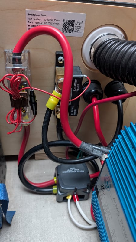

    I bought that same 4AWG cable but with M10 and 11.8". This is on my 2020 Tab400. I put the shunt between the battery and the factory distribution studs. I moved the inline fuse going to the inverter over a bit to make room for the Smart Shunt as well as re-organized the wires on the distribution studs.
