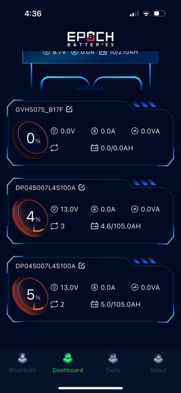

    Where is the solar charge controller? My manual has nothing since they came with regular batteries. Also I just checked on the batteries after being hooked up to shore power for 5 days and they are still at 4% 😐. I have the Epoch 105h essential series.

    I am looking at the Epoch app. They were at 100% when installed until the day we left. We were only gone 3 days. Came back, hooked back up to shore power and they won’t go back to 100.

    The other issue here is the actual status of the battery.  If this battery is below "10 Volts", that is what Epoch calls "low voltage disconnect".  On the Epoch display you show, the batteries down near "4 percent" and "5 percent" may be far below that 10V level, and the batteries have shut down.  I've looked at the Epoch web page, and they don't seem to have a good explanation of what to do in this case.  Other batteries that stop working in this condition can be recharged with a 12V charging source, like your solar setup.  This is why the Victron app and trying to determine if the batteries are charging through solar is important.
