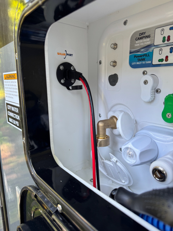

    Here are some shots of my final setup. I mounted the controller to a board and can attach it with velcro tape to the side of the camper inside the truck bed (out of the weather). I ran the cable up into the Nautilus unit to plug into the solar port.
