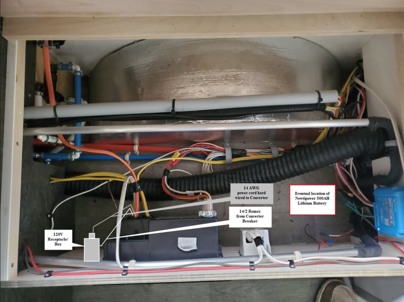

  • deepsea5deepsea5 Member Posts: 7
    When I put the Converter in my Tab 320 on its own breaker, I also mounted a 120 Volt receptacle next to the WFCO panel.  The receptacle is powered from the Converter breaker, using 14/2 Romex.  I cut off the female end of a 15 Amp (14 AWG stranded wire) extension cord and permanently wired it to the Converter.  The Converter now draws its power from the newly installed 120V receptacle.  The receptacle allows me to also plug in our Ecoflow Delta 3 Plus for charging, or plug in our 60A LiTime charger when I eventually install the 300AH Newtipower lithium battery.  It also makes it easy to disconnect the Converter-just unplug it from the receptacle.
    2021 Tab 320S Boondock.  2016 Toyota Tundra TV.
    Sabattus, ME & eventually Tucson, AZ
