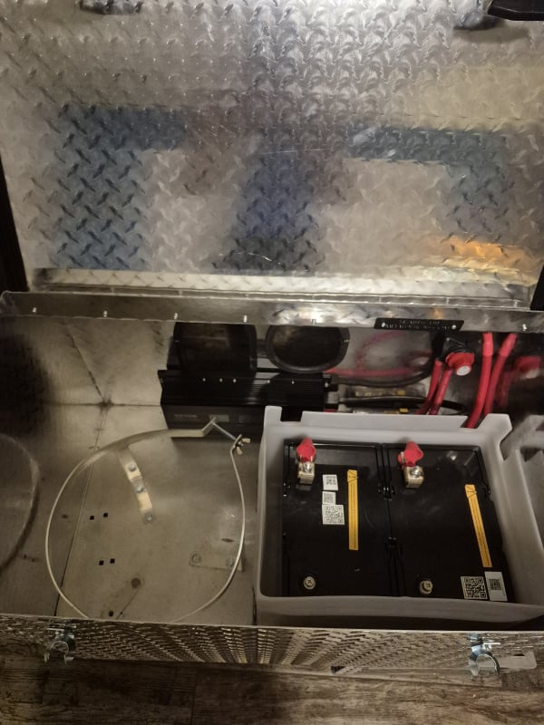

    I replaced my WFCO 8735P with the WF-8735AD but then needed a jumper sent from WFCO since everything I was told to do by the techs to teach it to auto detect failed.
    FWIW, my new setup is 2 Eco-Worthy 100ah lithium batteries with bluetooth, put into THIS battery box which is removable. There's a strap to hold it in place, but I made mostly everything removable so that when I'm not using it, it can go into my garage.

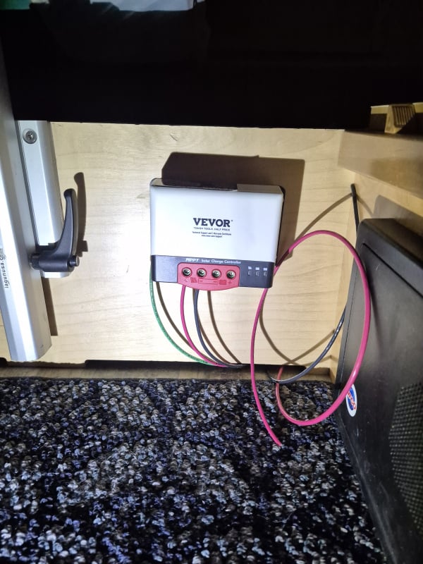

    I've also updated all of my solar adding a Vevor MPPT 30amp controller w/BT and a second solar panel on the roof.
    I can monitor (like a smart shunt) the batteries via bt. I added a Vevor 2000watt pure sine wave inverter installed in my new Sea Biscuit center tub, which I have not wired into the WFCO directly, however I separated out the breaker for the converter so as not to cause a back loop if/when plugging in my converter into the outside shore power to use 120v plugs. I simply plug the inverter into the shore power plug with an adapter and extension cord.
    This setup was borrowed from another person.  HERE's my discussion and the YT video I used to adapt this.
    I will see if I can find all of the discussions about how and what I did and create one discussion so if someone else wants to copy what I did they can. For now, here are some pics.
    BTW, the products I use are alot less than some of the common name brands but IMO and research and experience, they are just as good if not better. YMMV
