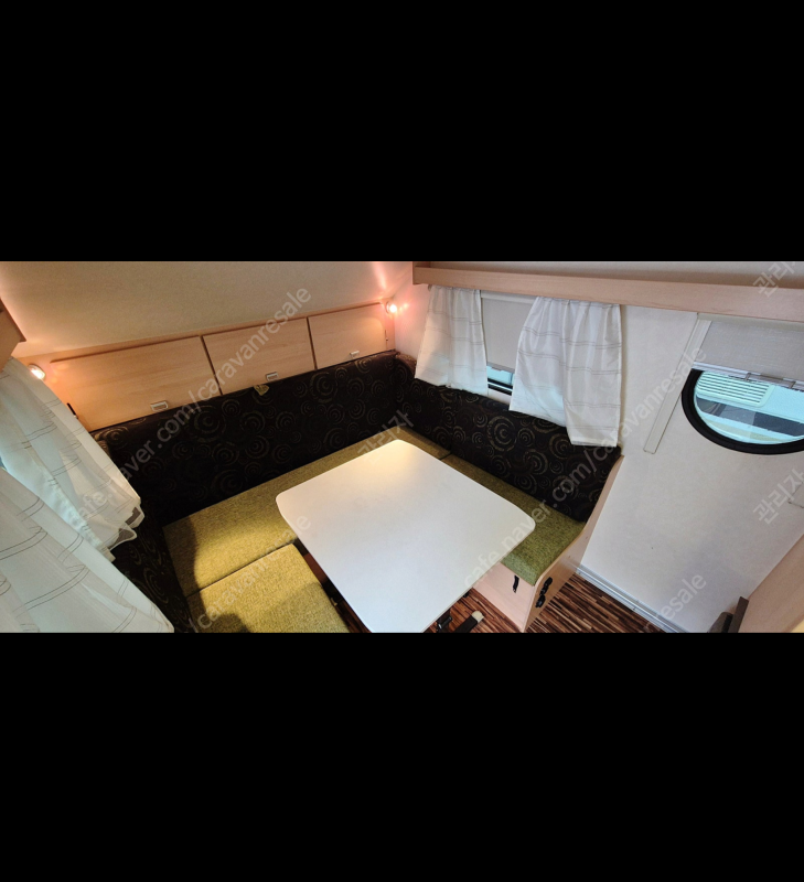

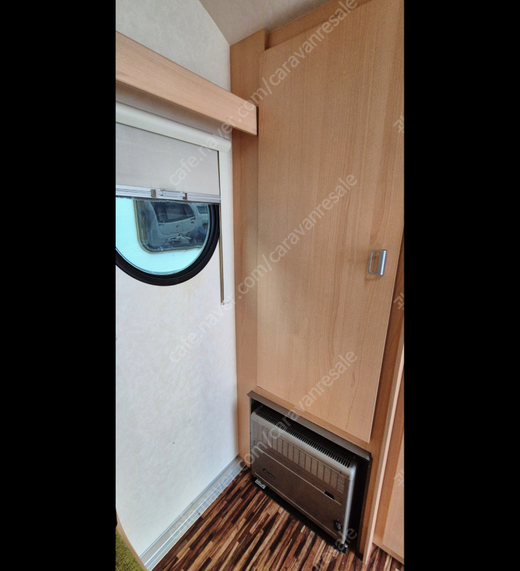

However, I live in a region that gets very humid in the summer. Unfortunately this EU model doesnt come with a ceiling fan or built in aircon. All it comes with is a gas heater which I haven't tested if it works yet. I also haven't tested the battery condition.
The following upgrades im considering:
- Installing ceiling fan where there's already an air vent.
- Replace the battery with a newer more efficient battery that can power a portable aircon.
- Install a portable aircon
- Perhaps replace the gas heater with an electric heater.
Anyways, I am completely ignorant on this subject. I just bought the trailer because it was super cheap and I thought it looked cute.

Nice trailer! The biggest difficulty in installing a fan is getting 12V power up there. You'll likely need to route the wire from the back along the wall/ceiling interface, then over to the fan, using some kind of conduit cover. The hole looks like a typical 14" square, so there are multiple fan options.Rich2019 T@b 400
@KasperKorea: The "deluxe" and the Low-Profile MaxxFans install easily in the thin (~1 ¼") roof of a t@b. The basic and "plus" versions need 50mm of roof thickness, so you'd need to build up some trim around the opening. Having done the latter (mistake!) I suggest getting a deluxe version, even if you don't need their fancy features.Horigan said:... The hole looks like a typical 14" square, so there are multiple fan options.Charles & Judy, Santa Cruz, CA
