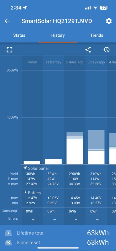

@ThelmaAndLouise can you show us the Settings page for your controller? It will be under the "Cogwheel" on the status page. It looks like your battery settings are fine...but lets see what they say.
On the history page, each day has a set of "bands" that show the various charging "stages" the battery had entered, and gives a good idea of how much energy the panels delivered. Going back to days 2/3/4, the darker blue bands show the battery was reaching a "float" stage, which means fully charged.
But, days 1 and 2 show little solar input, and the "max" voltage of the battery dropped quite a lot. It is the combination of the draw of the inverter and the fridge, along with little solar charging, that "seems" to have caused your loss of battery power over those two days.
Where were you camped? If you were parked in the shade, solar does not work well at all in those conditions.
Many owners supplement their "roof" solar with portable solar panels that can be out in the sun around the campsite if the trailer is shaded.

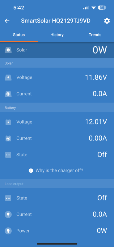

i do have the Vitron app. In fact, here is a screenshot of whats been happening after getting home and connecting to shore power:
