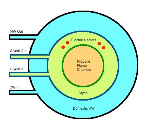

    Here's an illustration of what @Grumpy_G posted. When the cabin thermostat is calls for heat, the furnace heats up the glycol which in turn heats the water in the outer chamber.
    Edit to add that when the hot water is activated for either electric or propane, the glycol is heated just as it is for cabin heat. The difference is that glycol will not be circulated through the heat convectors if the cabin thermostat is not calling for heat.

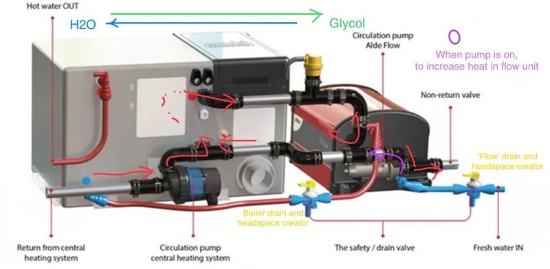

    Another twist on the hot water options comes if you have the Alde Flow (which I am thinking all the newer 400s might have). That has a separate tank to provide more backup hot water. There is a second pump that circulates hot glycol to this tank, but only when the hot water is set to the Max setting, and then it is set to reset to normal Hot water setting (midway) after 30 minutes. I am not sure how the internal plumbing looks on this variation.
