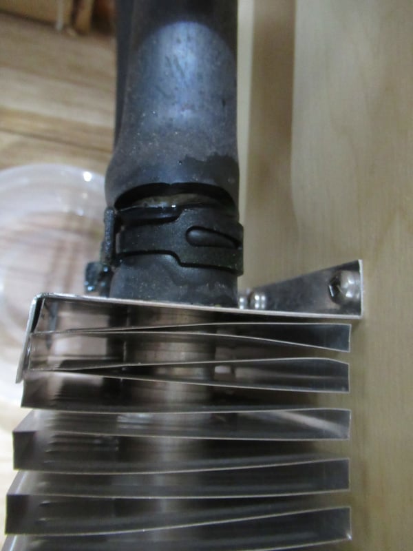

Have you looked at the radiation on the back wall? I have a leak where the rubber cracked and broke because of the bulge.

Thank you to everyone who commented here. These are some great suggestions. And thank you for confirmig what I thought I could do with distilled water. I am 99% positive there is no leak coming from the rear convector. Because that area is very dusty & dry with no streaks of any fluid running down that slanted wall. However I now have everything exposed & will confirm this. PT Thomas your suggestion of the auto bleeder makes alot of sense. I will post back when I get a chance to troubleshoot this leak. It may be a week or so, I have several other pressing things I must do prior to this & our camping season is now complete for a few months.2021 T@b 320S Boondock
