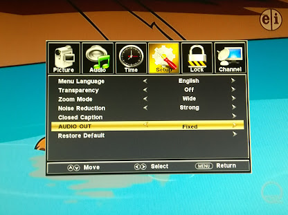

Here are a few questions to get you started:
- Do you have the correct "source" selected on the Jensen?
- Do you have the correct source selected on the TV?
- Have you changed the settings on the TV to mute sound coming through the TV (in TV set-up menu under audio)?
Here are some photos of my TV settings, if it helps.
2 -
