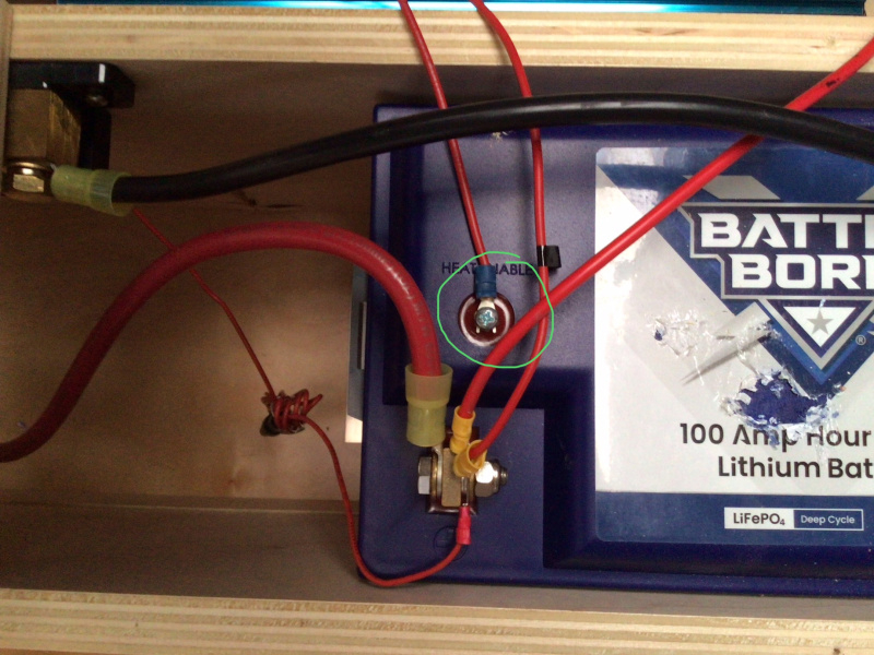

I am switching out the BattleBorn 100 ah Lithium battery, that came stock on the T@B 400 BD, with an SOK 208 ah lithium. The BattleBorn has an externally switched low temperature heater in their battery. There is a separate cable attached to the BB battery to activate the heater. I’m wondering what to do with this cable once I disconnect it? I assume I can just cap off the end of this wire and leave it as is? The SOK battery does not have an external switch, rather it has an internal switch that activates a heater if charging at temps below 2C. I attached a pic showing the BB battery with the red heater cable wire attached. Thanks.

I don't have this setup but was interested in how the heater worked so I found the attached from BattleBorn. Maybe that will help as it looks similar to yours.
Inside the manual it says:
Step Three: Deactivating the Heat-Enable Function To deactivate the heat-enable function on your heated Battle Born Battery, simply remove the heat-enable jumper wire from the heat-enable post. Remember to tape down the end of heat-enable jumper wire with electrical tape and cover the ring terminal so it does not make contact with other live wires or grounds. Be sure to put the heat-enable screw back into the post so you don’t lose it.2019 T@B 400 Boondock Lite towed by 2016 5.7L Toyota Tundra

Yes. I think one of the wires on the positive post goes to the switch so you can remove that one too.1

I also removed it my 360, when I upgraded my battery. I used that wire and circuit for a new 12V plug toward the rear (where there is not one). The battery heater wire in our 360 went to a dedicated fuse in the WFCO.

The wire is connected to a toggle switch to enable or disable the battery heat.JPP said:
...[snip]...There is a separate cable attached to the BB battery to activate the heater....[snip]...
My 2024 320S uses a lit toggle switch, as I show on my DC wiring schematic, bottom right:
https://i0.wp.com/donmontalvo.com/wp-content/uploads/2025/10/20251016-Camper-schematic-1800-scaled.webp
If your SOK doesn't need it, it'll be an unused switch I guess.Don Montalvo | Retired Veteran | Full time boondocker
