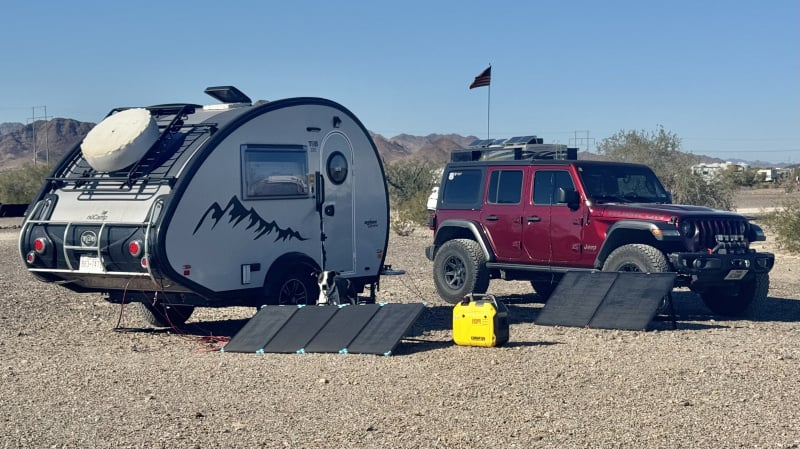

For my Jeep (JLUR), I run with a Rich Solar MEGA 200 Portable Briefcase Solar Panel (RS-X200B). It is a little on the heavy side since it uses tempered glass panels. It is connected to a Renogy DCC30S 12V 30A Dual Input DC-DC On-Board Battery Charger with MPPT (RBC30D1S) in the Jeep. It charges the Renogy 12V 100Ah LiFePO4 (RBT100LFP12SH-US) off grid battery in the Jeep. Here in Quartzsite, AZ, it is Winter so the sun is a little low, but the above combo easily keeps the LiFePO4 battery topped off. The DC to DC charges the battery from solar when camping, or from the Jeep's heavy duty 240A alternator (part of the towing package) while driving.For my T@B 320S BBC, I run with a Renogy 220W Lightweight Portable Solar Panel Suitcase (RSP220LSC-US). It is connected to a Victron SmartSolar MPPT 100/30 that I installed in the Nautilus compartment's SAE port on the camper. It keeps my two Battle Born 12V 100Ah LiFePO4 batteries (a BB10012H and a BBGC2H set up in parallel) topped off easily on sunny or partially sunny days.
I didn't mention the 380W flexible panel on the camper's roof, since the OP asked about portable panels. I used to hang a 100W flexible panel under the roof rack, but that was before I bought the second solar suitcase. I might use it later if I buy a battery pack later on.
A couple RVers here at Quartzsite, AZ have a Renogy 400W suitcase. They're huge but the RVers say they're incredible, but harder to store than the 220W suitcase.
I schlep a Champion 2500W gas generator that I only use when there are stretches of rainy days and the batteries need charging, or when the temp goes into the high 80s and I need to run the Air8 air conditioning (which I set up with a SoftStart RV (the hard wired model). I keep a 5G fuel can attached to my Jeep spare tire, so good for five days of generator running.
