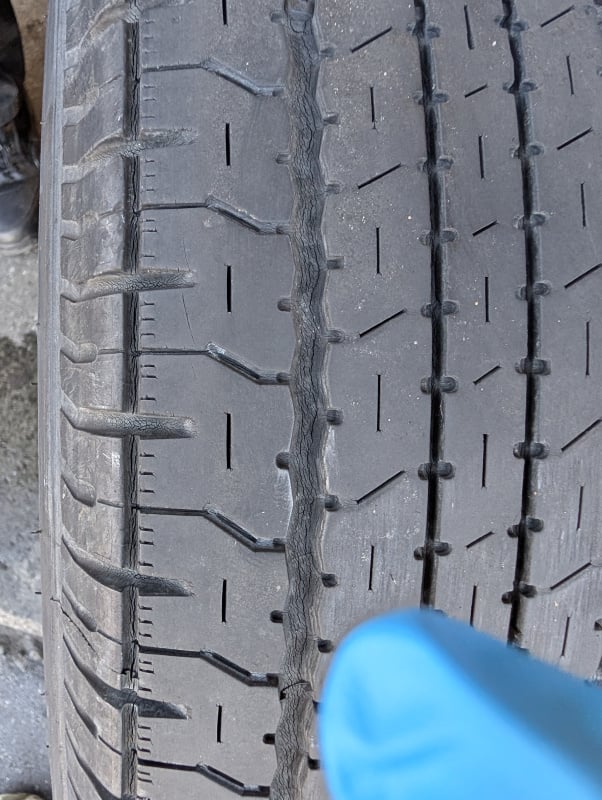

I had Goodyear Endurance tires installed on my 2019 T@B400 in 2022. The date code on the tire indicates they were manufactured in 2022. I am diligent about maintaining the correct tire pressure. Recently I noticed cracks in the tread grooves on both tires. I returned them to where I bought them, America's Tire, and they offered me a credit on replacements, which I accepted. Much research tells me the Goodyear Endurance is a top rated, high quality tire. So what's up with these? I guesstimate I put 20-25,000 miles on them in the last three years. Remaining tread was 4/32". The spec says new they have 8/32".
As a side-note the technician showed me my right tire was wearing a little faster on the inside (3/32" tread depth) than the outside (5/32".)

    Do you put tire covers on when stationary? What tire pressure do you inflate to? I'm glad you found the cracks before anything happened.

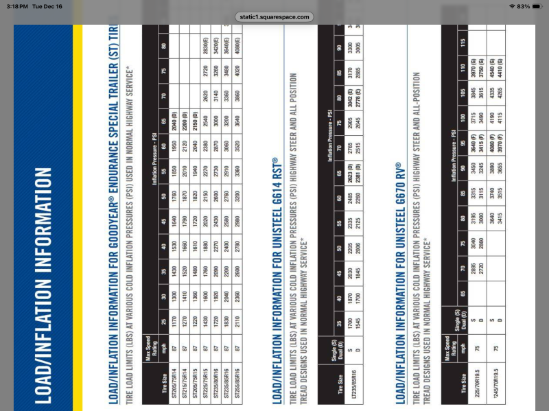

     Go to Goodyear endurance web site and there is an inflation chart for the size of tire and weight of the trailer . Use these rates to inflate the tires.

    I would pressurize to the pressure listed on the trailer, front left side on my 2019 400.  Sometimes these are less than the Max tire pressure.  In my view, using the max pressure is fine, though the ride may be a little rougher than it could be.  Those cracks aren't due to running at max pressure.

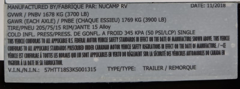

    I'm considering what the correct pressure should be. The original tires were load rated C, 6 ply, Max 50 psi. The Goodyear Endurance are 8 ply, D load rated 65 psi max. I can't find a tire pressure recommendation on the Goodyear site. Google returns information from third party sites on tires pressure but I can't verify that it is an official Goodyear recommendation.

    Check this

    On my '23 400 that came standard with the Goodyear Endurance tires, the factory plate on the tongue indicated 65lb pressure.

    @MOS2 I saw that pdf of pressure on a non-Goodyear site, couldn't find it via Goodyear's site. I see you have a 2025. What pressure is on your factory plate?

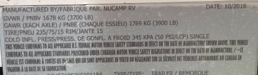

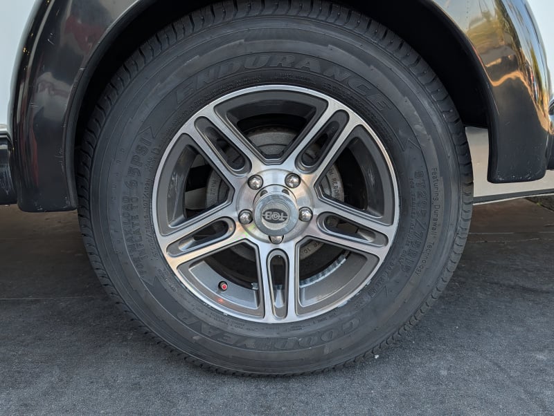

    I have a 2019 400 made in late 2018 jimcenname and my load sticker seems to match what was on my OEM Rainier tires (50psi). I just got Goodyear endurance ST 225/75 R15 load range D and my max pressure on those is 80psi.
    Are your tires ST or LT?

    So @jimcenname I see the difference now. The Boondock T@B 400 I have must have come with the larger tire (which is why it is such a pain to get them off around the trim for inspection and service). I am running my new 225/75 15 Goodyear endurance at the max rating of 80 psi, and I have seen no issues with towing. Mine are still pretty new so no info on wear.
    So the question is if the label will apply to ALL tires mounted on your rims, or just the OEM tires? I know in cars the door panel psi is the supposed correct psi despite brand?

    Your tire has a load rating printed on it . All tires have this .  Use the load rating and the GVW of your trailer , to come up with recommend tire pressure .
    Use the chart .
    I have 44 psi I mine .

    Do you camp in high heat areas like desert environments? Running them at max load shouldn't normally affect things other making the ride a little rougher. The only think I can think of for the uneven wear is an unbalanced tire or an axle problem. Do you have your tires balanced when you get them? Whenever I get new tires I always have them balanced. I also have them check them whenever they do my wheel bearings too. If you hit a curb or other obstruction it can easily cause an unbalanced tire which will definitely cause uneven wear.
