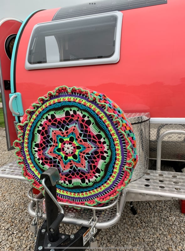

Does anyone have a full size spare mounted underneath shipped that way from the factory?We have a full size spare on our 2019 320 Boondock. It actually shipped from the factory to the dealer mounted underneath in the back but I wanted it on front because I crocheted a cute cover for it. Well now, the cover is fading and I’d rather have the space for a storage box. I never paid attention when we got it how low it was to the ground and am worried about going thru the trouble to move it and it doesn’t work out. Any ideas or tips?*Older post but hopefully someone will see this.
We've slept in 36 states, 2 countries & counting0 -
Mine came like that (2015). Are you seeking advice for returning it the original mount at the back?2015 T@B Max S (320)
