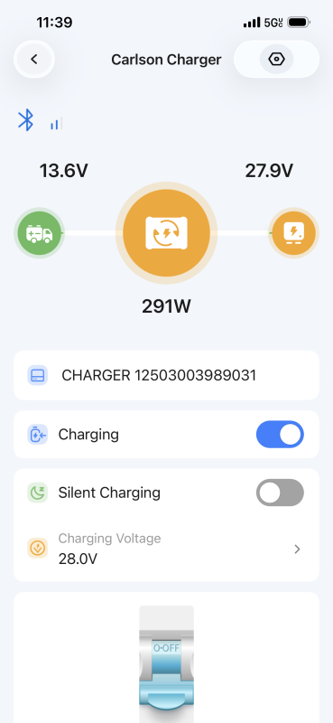

  • rcarlson1957rcarlson1957 Member Posts: 259
    edited December 2025
    Have 100ah lithium with non-lithium WFCO converter and never shut off battery. 5 yrs and 65k miles and never a problem.  If need that extra 15%  just always used our portable solar panel to top it off. But we usually camp at places with shore power. But now we are doing more camping without shore power like Harvest Hosts. Recently installed a Bluetti Chargeer 1 alternator charger and use it conjunction with my standalone Victron 100-20 Solar Controller (my 2018 320 doesn't have rooftop solar). Get a steady 290 plus watts just driving down the road so tops of battery pretty quick and alway arrive at campground at 100%. If boondocking and solar is iffy can just hook up to truck for a bit and charges right up. Plus, since output voltage can be set manually, when I'm unhooked and going somewhere with just the truck can connect to my solar battery and charge it up quickly too. Different ways to get there I suppose.
    Trips - 48  Mileage - 63,452

    ...Recently installed a Bluetti Chargeer 1 alternator charger ...
    @rcarlson1957
    Curious.  The Bluetti Charger 1 is rated for 580W.  Do you know if you're only getting 200W because that's all the Honda alternator will put out, or due to small gauge wiring to the trailer battery (580W would call for 6AWG), or a combination of both?  I've wondered if modern smart alternators would put out 500W (40+ amps) and whether it would be worth running 6 or 8 AWG wire thru the TV and to the trailer battery.
    Horigan - Sorry I posted incorrectly and fixed it my original post. The Charger 1 can output up to 580w at 10 amps when you set it's output voltage to the max of 58v. One of things I like about it is that you can manually set the output voltage via their phone app. But my Victron 100/20 solar controller can only handle a max of 290w on it's 12v setting so it. So I set the Charger 1 output voltage to 28v and it limits is to that max wattage. I also have a Bluetti EB3A solar battery that takes a 28v input too. So I keep the Charger 1 set at 28v so I don't have to change it's output voltage setting when I switch between charging my 100ah lithium camper battery or my solar battery. With the Charger 1 it is very important you always have the correct output voltage set to the correct input voltage for your solar battery before you hook it up or you can damage the solar battery. By setting my Charger 1 to 28v I don't have to worry about that. If I got a bigger solar battery then I would have to take that into account each time I switched. The Bluetti Charger 1 normally comes with some nice 6awg wire with a wire mesh protector that is just under 16.5 feet long with a switchable breaker on the Charger 1 input end. I installed a separate breaker 60amp breaker with manual reset by my truck battery. I installed the Charger 1 on inside drivers side of my Ridgeline truck bed (it's under a tonneau cover). I was able to run it thru the inside front fender well into truck cab and under the front and back seat sill plates and then behind the rear seat and out into the truck bed. I've been using it for quite awhile now with no problems. But since my truck has a smart alternator I do have to run the truck with the lights on for it to work properly. Here's a picture of the Charger 1 when it's running and charging my camper battery.
