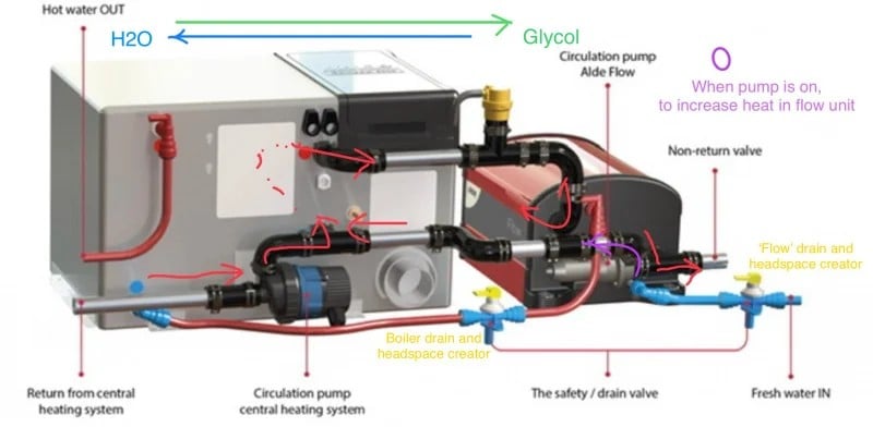

    @madhatter1620 I would fill the tank and identity the leak before pouring in more of the expensive glycol. Also check under the shower by removing the panel under the shower to see that convector space. The kitchen requires a bit more disassembly to see that one but the floor should be wet under that cabinet. As @pthomas745 mentioned, identify the black tube from the overflow valve which has some clear tubes with it going to the grommet in the floor and feel if there is glycol there. Here is a good diagram on the Alde in the 2019 if you have the Flow unit:

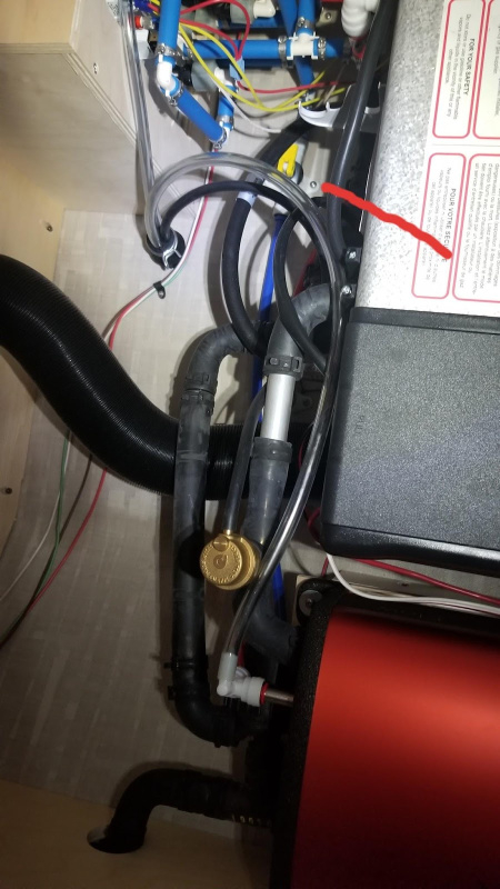

    Picture below shows a 2023 400 with the "grommet" in the floor.  The black hose is the one from the Auto Air Bleed Vavle (the brass fitting).  One clear hose is from the hot water tank drain vent on the side of the Alde.  The other clear hose runs to the expansion tank itself.  The expansion tank hose acts as another glycol escape route.  If the glycol was overfilled, or the system "backed up" in some catastrophic way, the glycol could come out of the top of the tank and come out of that clear hose.  It is normal for "some" residue to be in that hose, due to the trailer rolling down the road and the glycol sloshing around a bit.
