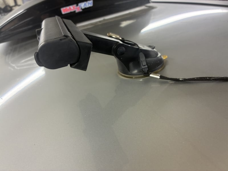

Have you considered a suction cup mount just above the running light? You could still steal power from the light. I mounted a camera high on the roof of our 320 so that, along with seeing traffic behind, I could keep an eye on the stuff on the roof rack.
note the tether so that I won't loose it if the suction fails
(hasn't in thousands of miles)
