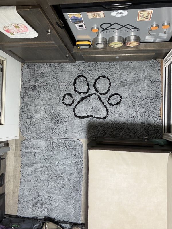

    I was being sarcastic in my previous post hoping that some one would comment. Does the 2024 320 T@B have radiant heat in the floor? I've never heard of that.
    Regardless, this is the carpet we use in our 2020 320S. Works well as long as you don't block the intake for the convection heat.

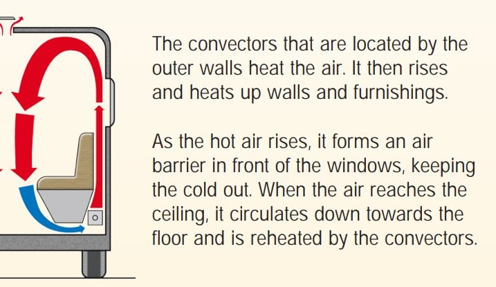

    The TAB 320, 360, and 400 do not have "heated floors".
    The 400 does have heat under the wetbath shower pan . . . but not a heated floor as such.
    Like This:
