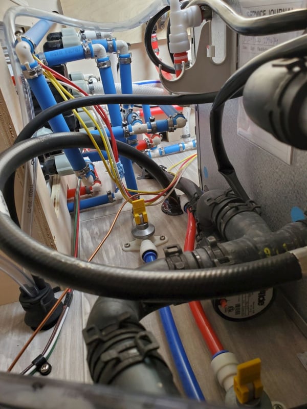

    Here is a picture of where the Yellow valves are in your trailer.  If the water stopped draining after you started pumping water, it "probably" isn't
    a yellow valve issue.  Note: the valves in this photo are Open, and they should be horizontal to be closed.
