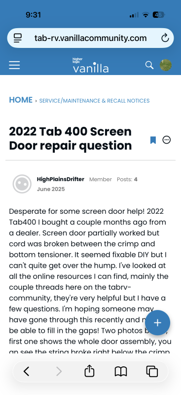

    @JP2558 I’m not very good at navigating this site, but if you go to the thread below (you’ll have to search for it; it’s not a link), the seventh or eighth comment (from me) tells about a source I found for a new screen door for about HALF the landed price of a replacement door from NuCamp. It’s easy to install and is better quality than the original door used by NuCamp.
    Hope this is of some help to you.
    Gary
