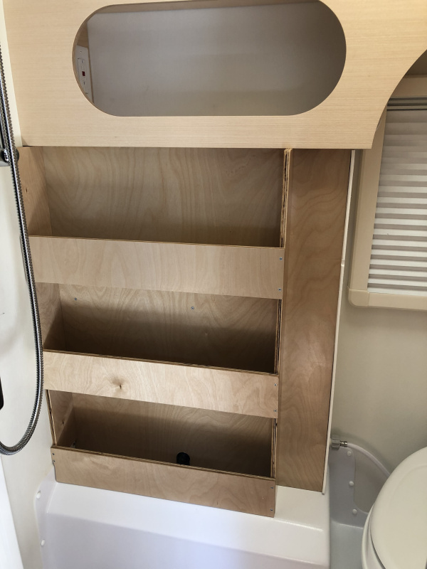

    Here's a pic of the shelving I put in after our sink removal. The 1/2" birch plywood isn't as dark as the picture implies.
    Rich

    Rich, your mod is actually one of the best space savers in the bath area I have seen.
