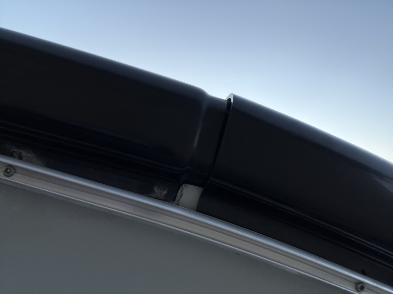

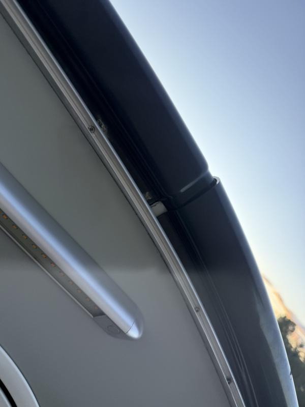

Greetings fellow Tab owners! Can anyone provide help on how to repair this loose piece of trim on a 2021 Tab 320 Boondock. Maybe remove the trim and replace a fastener or something? Thanks a lot for any info. My Tab is pretty much perfect except for this and of course it drives me crazy.

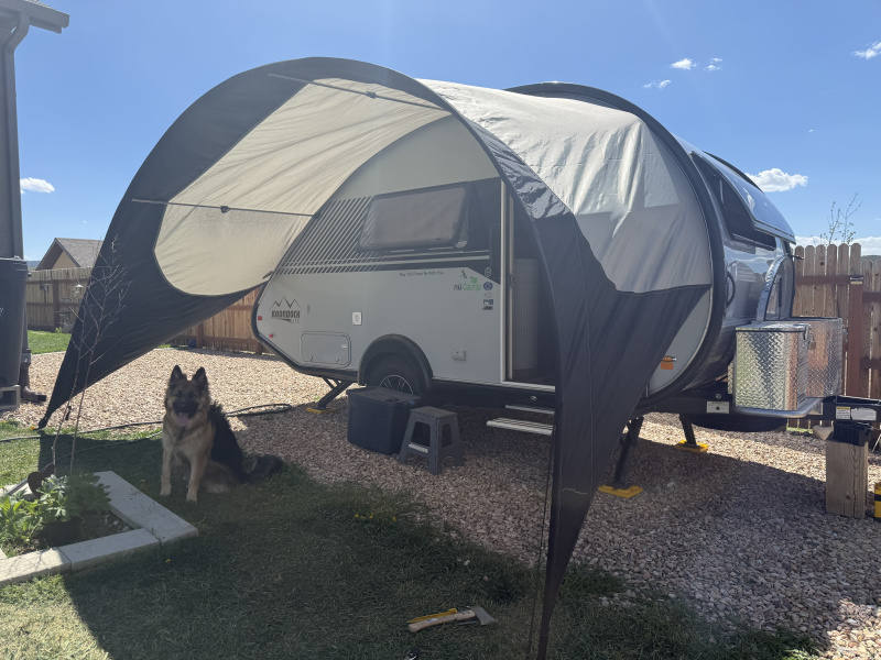

Do you have the All Pro Adventures awning by chance? I have that one that came with my Tab but I have not tried setting it up yet. If that's the one you have, please share any feedback. Thanks!

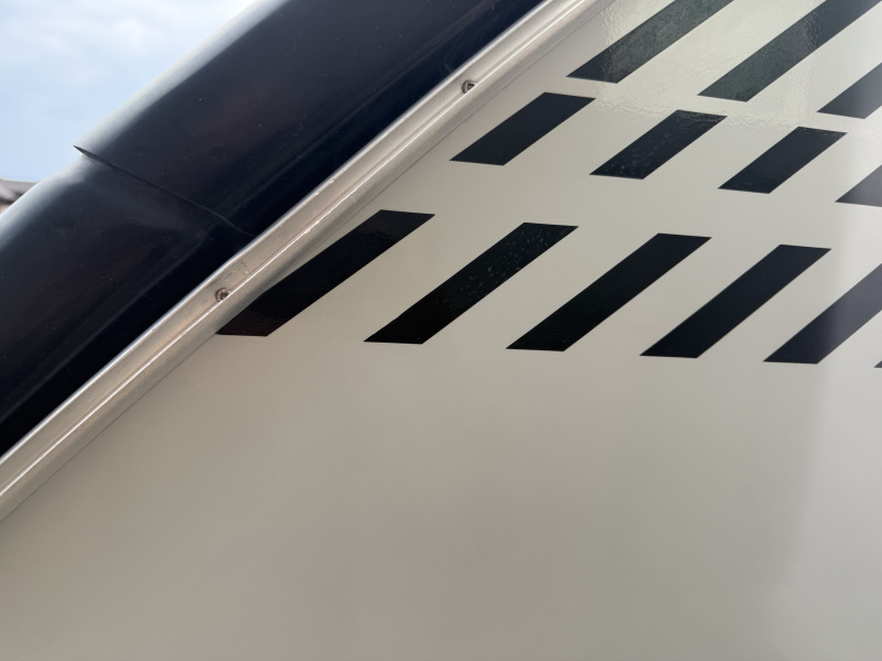

This is what my trim looks like right now…. I’ll try to get it repaired soon, once I figure out how to do the repair properly.
PS… the above image has both the trim and rail shown. The rail is aluminum and the trim is the black plastic. The rail is where your All Pro awning will slide through. You’re may still have the black ‘filler’ ( not sure what to call it) in it.
I also recieved an All Pro Adventures awning when I purchased my new 2 me 2020 camper. It works great! Check out their website for all your questions… it’s easy to set up and has made it through some pretty heavy wind and rain this summer. I have to use a small step to set it up. This images was taken in my back yard when I was testing the setting up the awning earlier this year..

Things changed for the 2021 and later models. The black plastic trim is not held in with any screws. The trim fits inside of a thin groove that is on top of the keder rail and it's held in by adhesive and metal clips that fit inside of the groove.
Removal isn't real easy. Run a sharp blade in the groove along the outside of the trim to break loose whatever adhesive you can. Then you can pull up on the black trim while getting a flat blade screwdriver in the groove under the trim and prying upward. It's a bit nerve wracking, hoping the trim doesn't crack.
After removing the offending trim pieces on mine, I spent some time with a spokeshave to improve the fit within the groove. I think on the first iteration (2021) the curve of the trim piece didn't quite match the curve of the trailer. Then I carefully cleaned the groove with a manual grout removal tool and razor blade, cleaned it with mineral spirits, reglued the trim piece with adhesive, then taped it all down with blue painter's tape. It's held for about 30k miles over lots of rough roads and high winds on the interstate. I still check it regularly.
The trim in purely ornamental. There is no breach into the skin so the condition you show will not cause any water issues. However, several people did have that piece of trim fly off while traveling down the highway, so it could cause a hazard for other travelers.
