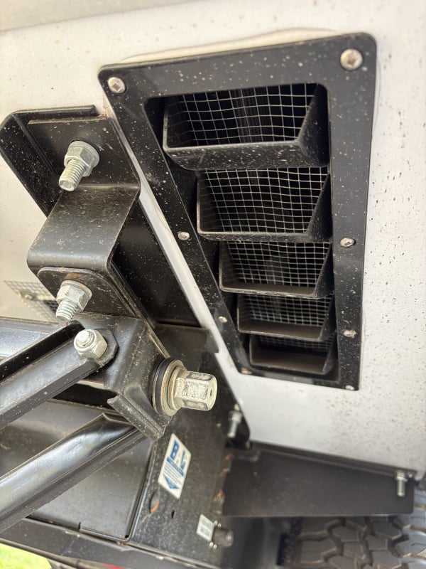

    It seems my 2025 320 actually does have an external diverter of sorts.
    I used the AC on my first camping trip in the Tab back in October and I haven’t had to use it since, been using the Alde instead. I downloaded a decibel meter app because I want to know how loud the AC is both inside and outside. It’s mostly the outside I am concerned with since the state parks I camp at often have people camping in tents mixed in with the RV spots. I just don’t want to be “that guy”. I am curious if any Tab owners have had any comment on the outside noise..
    That is the inlet vent for the Air8 condenser and the louvers are to deflect road spray and debris from entering.  The outlet is a ~5inch square opening on the inner side of the frame through the black Plasticore.
  • mx4789
    mx4789 Member Posts: 74
    >>that is the inlet vent for the Air8 condenser and the louvers are to deflect road spray and debris from entering.  The outlet is a ~5inch square opening on the inner side of the frame through the black Plasticore.
    Thanks for the correction!
