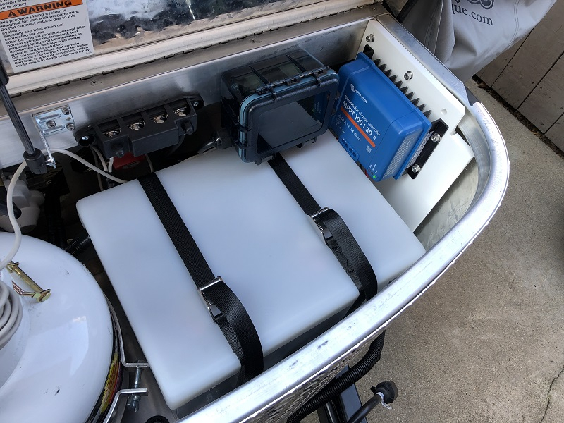

    @ReenieG.  I am very happy with the box and straps.  I now have two Group 24, 12V lithium batteries in the same box and they fit fine.  I actually had a little room to spare, so I tucked some foam insulation between the two batteries to keep them from rattling around.
    Because I wanted to mount the bus bar and shunt on the back wall of the tub, I ended up cutting the height of the box down about an inch (used a table saw).

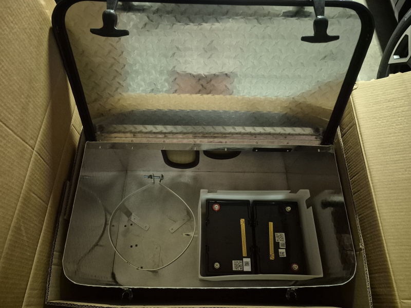

  • ReenieG
    ReenieG Member Posts: 283
    edited July 2025
    I just received my battery box today and the box and batteries fit great in that space!
    Now, the next step is to install the box.

    Basil48192 Member Posts: 444
    @ReenieG
    The white plastic is simply a cheap, plastic cutting board that I trimmed down to fit the space.  I mounted it to the aluminum, square frame on the storage tub.  It was 1/2" thick, so I drilled and tapped holes into it to attach the solar controller.
    On the back of the tub I mounted a negative bus bar, and my battery monitor shunt (inside a cheap, plastic box).
    All of the aluminum is relatively thin, so I bought a threaded insert tool from Harbor Freight.  It basically works like a large rivet gun, but fastens threaded inserts to thin sheet metal.  It worked great for fastening all of those items to the aluminum.  I don't like sheet-metal screws in aluminum.
    45 Piece Threaded Insert Riveter Kit
    Regarding your battery situation:  I have the same battery capacity, but I have the 2-way refrigerator.  I've heard that the 2-way uses less power than the 3-way...but I don't really know.
    I do know that with 200 AH of battery capacity, I can camp just about indefinitely....as long as I get decent sun at least every other day.  During my last trip, I was out for 5 days.  I ran my refrigerator continuously, lights, water pump, fan, etc. as needed.  I would consume about 23 AH per day.  I have a 105 watt solar panel on the roof and a 200 watt suitcase.  Because we had very good sun, my batteries were back up to 100% by mid afternoon every day.

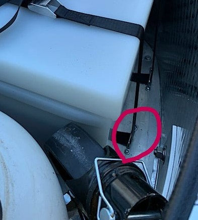

  • ReenieG
    edited July 2025
    @Basil48192 Here's a closeup of @Verna's pic. I can't see the bottom of your box nor can I tell if these are the screws that come with. Did you use the ss screws that came with the straps? If not, what did you use? TIA
