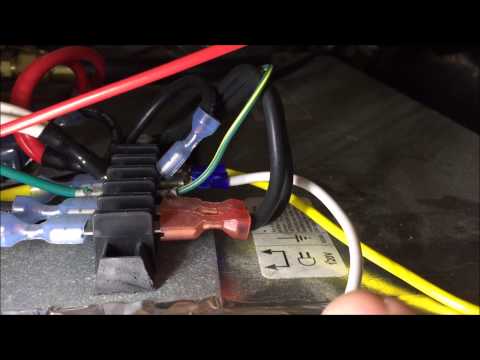

Here's the instructions I received from LG. I have converted it to a PDF file. The fridge in the instruction sheet looks like a newer model. I wonder if it produces less heat...
They also sent me a link to their video:
https://www.youtube.com/watch?v=afQqYz88RpM
Jiro0 -
JiroTX - Could you start a new thread - maybe titled "Norcold 3-Way Fridge Exhaust Fan Kit" or something and post your pic and PDF? - This topic needs it's own thread as it affects anyone with that fridge and this thread has a couple of tangents going on. Thanks

PXLated, I have created a new post with the title you suggested.
