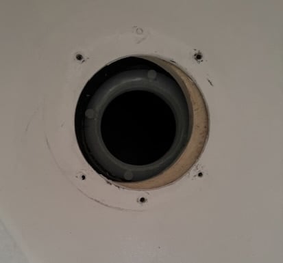

    Talking about a wobbly toilet.
    We bought a new 2025 TAB 400 and yes from day one the toilet wobbled.  So i removed the toilet and found a cracked flange - others have found this issue too.  Anyway, NuCamp sent a new flange. When i tried to instal it i noticed the flange would not screw in flush with the floor, one side was about 3/16 inch off the floor and the other side was tight on the floor.  So, i unscrewed the flange and looked at the bottom of it to see a swirl mark all the way around the angled area of the flange (see pic).  Looking down the hole into the black tank i can see the wood sub-floor (see pic) was not properly centered or enlarged enough and the flange was rubbing on the wood to the point that the flange would not screw in properly.  So, i re-shaped the wood sub-floor to 45 degree angle.  Now the flange fits properly and the toilet sits flush on the floor.
