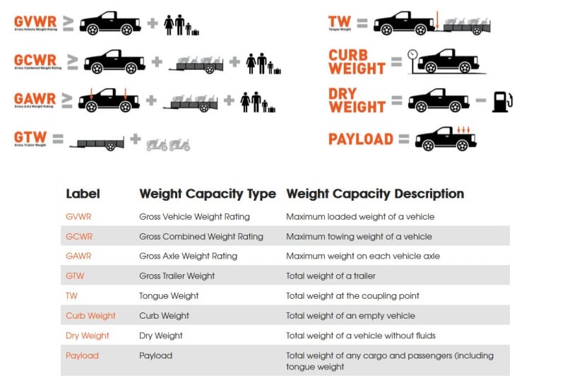

Towing capacity is reduced by everything you carry, but it's a non-specific term for all of the various tow ratings. Most vehicle manufactures list the gross trailer weight (GTW) as the tow rating in their literature. That is the rating for the weight of only the loaded trailer and doesn't consider what's in the tow vehicle. It's sometimes a confusing balancing act between all the various ratings. They all have to be considered, but I think that the combined rating (GCWR) is not stressed enough. That's the one that includes everything; driver, passengers, tow vehicle, trailer and all the gear and supplies loaded in both.

Unfortunately GCWR rating is rarely available for the light duty passenger vehicles many of us use for TVs. Given that and the common safety recommendation not to exceed 80% of rated towing capacity, subtracting TV payload from rated towing capacity is the prudent choice. Using wishful rationalization to justify carrying excessive loads is unsafe and a risk to you and those traveling near you.
edit: corrected to GCWR - thank you Grumpy_G1 -
@annbythebay, I think your main limiting factor will be the tongue load limit, which I believe is 350 lbs when the tow limit is 3500 lbs. Toyota/Lexus manuals also require sway control of some sort for trailers over 2000 lbs.
In general, I find that once you confirm the trailer is under the capacity (GTW< 3500 lbs), the next limiting factor is the gross vehicle weight, GVWR, which needs to include all vehicle cargo, occupants, AND tongue load.Rich2019 T@b 400
Actually the GVWR is on the sticker in the door jamb, it's the GCWR that is not shown on the vehicle. Add to that that at least in the pickup truck world the GCWR and with that the tow rating can vary widely based on engine and axle ratios and it becomes very murky.rfuss928 said:Unfortunately GVWR rating is rarely available for the light duty passenger vehicles many of us use for TVs.2 -
