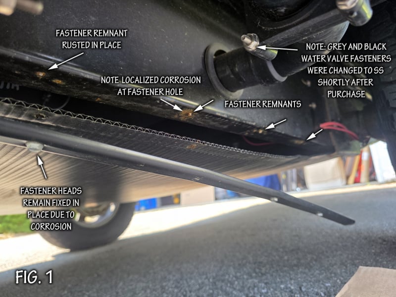

    What a great forum we have here. I just finished fixing this issue on my TAB 400 and wondered if there was any note about it in the Forum. And well, there certainly is and thank you everyone for contributing.
    Those broken fasteners became an issue for me when one broke leading to the neighbor fastener breaking and the next and the next…etc. The first look kind of makes you angry that there is no real quality control here. I mean we all bought these expensive little trailers thinking there were craftsman putting them together. I should have known better but anyway, for the most part nüCamp makes a pretty good product.
    As with everything that I have found so far, once I remove the first fastener I am certain to go in there and clean up any shortcomings. The truth is, the fastest fix is to make it while you have the patient opened up.

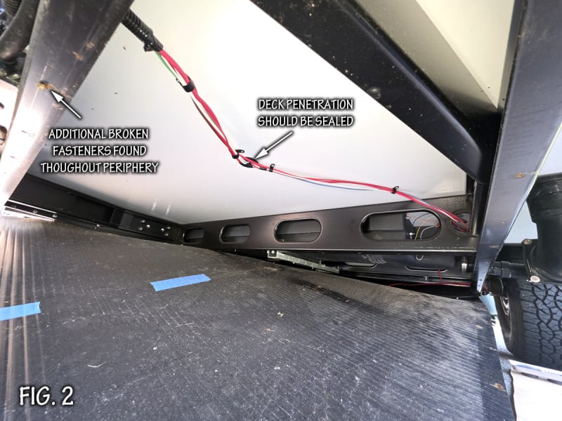

    I then started taking the retaining strips off and dropping the whole front of the pan. With the pan down I saw even more work to be done and at that point had to focus on the main issue and not rebuild the underside just yet.
    The failed fastener issue involves more than one issue. The obvious issue is the choice of fastener that nüCamp made. The size is too small and perhaps a SS fastener would last longer. But first look at what is happening here where the fastener and the material that the fastener is secured to is corroding. Honestly there is not a lot that you can do since we are dealing with three different metals on the undercarriage where water and most likely salt will be present. If we add SS (Stainless Steel) to the mix it opens new problems where the fastener is the most noble metal. There are other issues to related to the quality of the SS and from there I will go down an even deeper rabbit hole, so lets move on. The zinc plated steel fasteners should be okay as long as they are not over-torqued. But I might go the way of SS with some sort of insulator or filler like Tef-Gel to keep the SS fasteners from reacting.
    After I dropped a section of the pan to remove the broken fasteners, I kept finding more things to fix. For now I will stay focused on the fasteners. I used vise grips and some PB Blaster penetrant to remove the fastener remnants. I then cleaned everything inside the undercarriage and coated the metal parts with Fluid-Film to slow and help prevent corrosion of the metal parts. I also noticed that the deck penetration near the A/C compartment is not sealed. If you want to keep the insects/spiders down, seal all of these.
    For now I used zinc plated self tapping fasteners nearly identical to what was removed to close up the belly pan. I will have to do some research and source the new fastener before I swap them with SS or whatever. I used some 5/16" by 3/4 black foam strip around the periphery before securing the pan to seal any gaps and minimize any road dirt, salt and spray from entering the void space above the pan.
    I plan on making the undercarriage winter proof so there is no doubt I will be back inside the belly pan.
