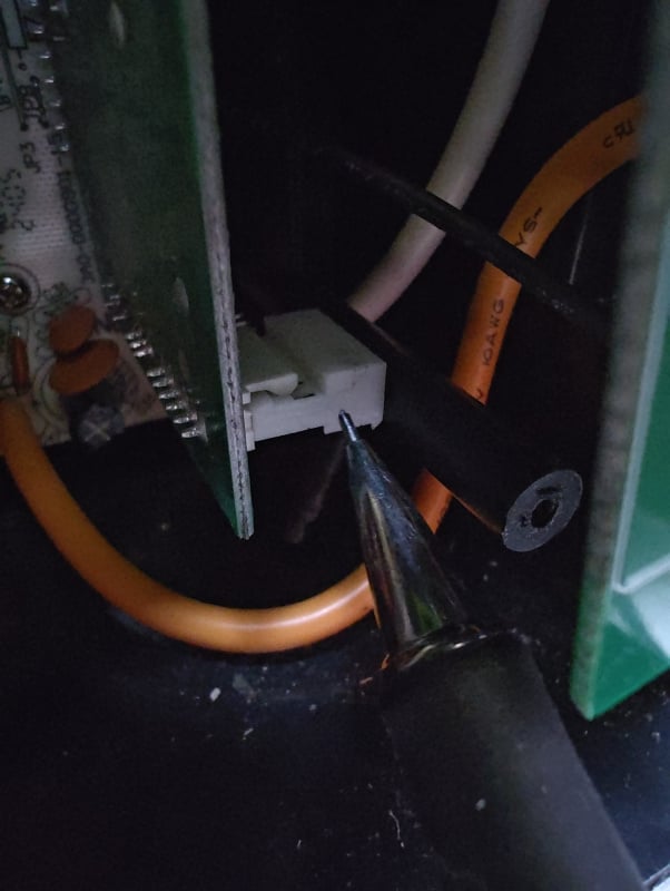

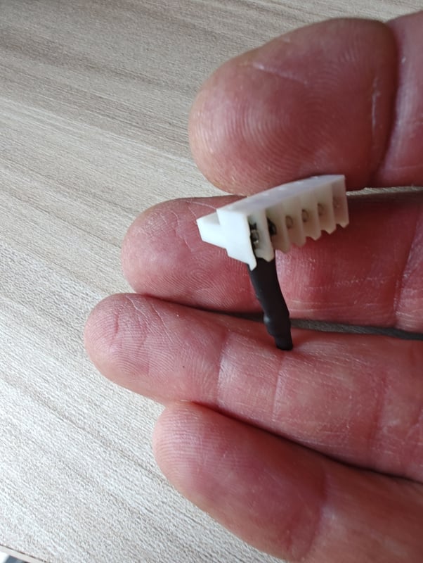

I'm late to this conversation but I would not pull my unit or send anything back to them without trying the resistor fix. 1K ohm resistor across the first two terminals puts it in lithium mode. Nothing needs to be removed and it takes a few minutes to do. You can solder it or make a little jumper. WFCO sent me a pre-made jumper. It's a 5-minute fix, or at least it was my unit. Stupid design but it is what it is.

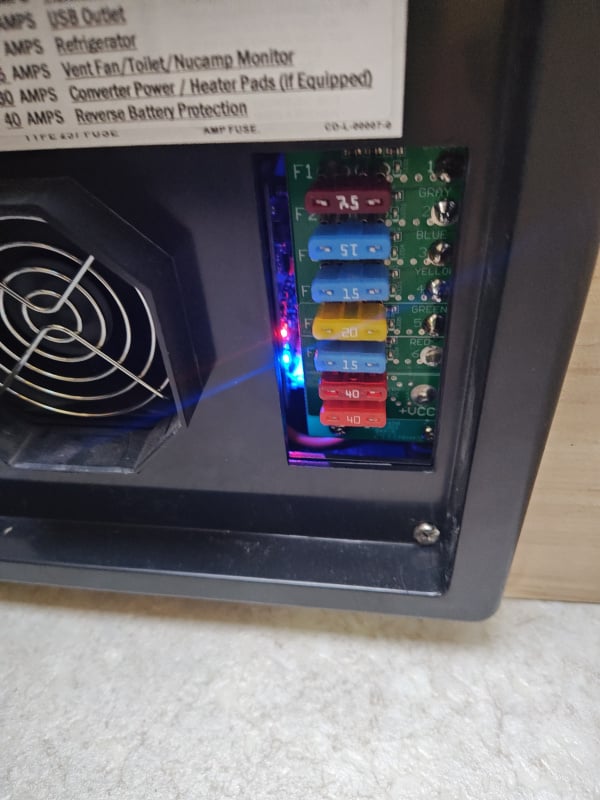

Hi, Does the inside cover of your WFCO have a sticker for "lithium batteries only". Our 360 has the 8955AD but has this sticker inside. That would seem to mean the mod. has been done?cschaepe said:Well it's 2025 and apparently WFCO & Nucamp still haven't figured out that there is a problem that a simple 5cent dip switch/resister could fix. My new Tab360 trailer with a Epoch Lithium battery is not recognized by WFCO as a lithium battery.
Is the only solution now to DIY it? Does WFCO offer a service to fix there substandard engineering?2025 360 CS
Southern Maryland2 -
It is a 8940AD and doesn't have a sticker maybe they figured out they better start using Lithium only. Maybe yours is newer.Yoshi_TAB said:
Is the only solution now to DIY it? Does WFCO offer a service to fix there substandard engineering?0 -
There does seems some difference in newer builds. Mine is a June 2025 build. Maybe reach out to NuCamp warranty..maybe they will swap and send you the other model directly to you or your dealer. Mine also came with 4AWG (vs 10AWG) wire, which I've been wondering why. This may be contributing to your charging issue.2025 360 CS
Southern Maryland1 -
