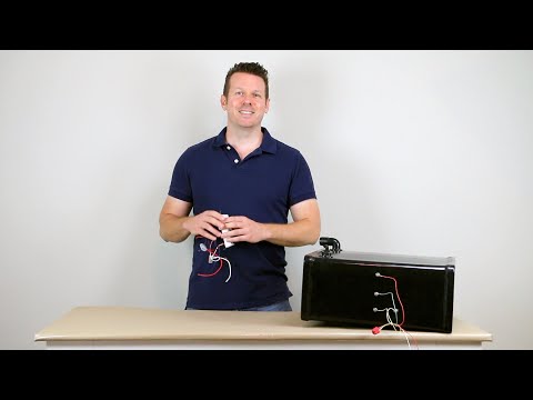

The KIB tank monitors (and the SeeLevel monitors in my 2017) are a bit different than I though they would be. Skim through this video a bit and have a look at what the tank monitor sensors are and what they are trying to do. It may be just a trailer trying to break itself in, but if the terrible readings continue, someone may have to take a look at the sensors.

Thank you again for the Video! Knowing how it is wired has me suspicious of a bad ground at the terminal block of the KIP panel to the two tanks... Opening panel to check Cheers!Ultimate Toys Teardrop Camper
