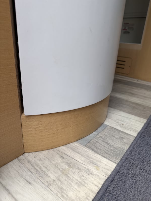

Veneer coming off of kitchen sink cabinet base on our 2023 Tab 400
After owning our 2023 Tab 400 for less than a month the veneer at the base of the kitchen sink cabinet is coming off both ends. Apparently it used to be solid wood but not recently. I've heard that others have experienced the same thing. Below are some photos.
I was disappointed that nuCamp Warranty would only say to bring it to our dealer but they are 4 1/2 hours away which makes it not worth the drive. I thought that they would at least recommend the best way for me to fix it. In particular what kind of glue would work best, how to apply it without ruining it more and how to clamp it while the glue dries. They said the only thing they could do is to send us a new piece and that they could not recommend glue as the way they apply it is using an iron and if I did the work it would void the warranty.
This should not have happened in the first place and now I'm left to figure out how to fix it on my own. Any help would be appreciated.

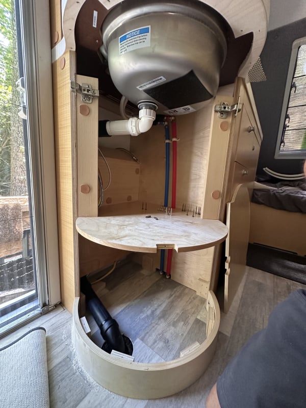

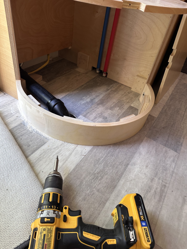

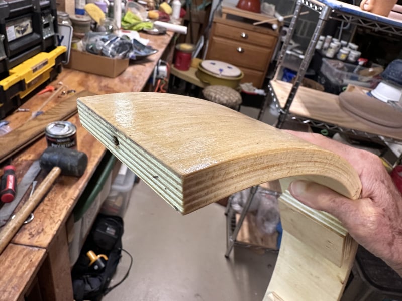

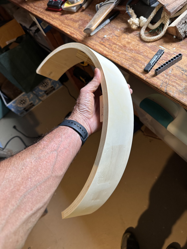

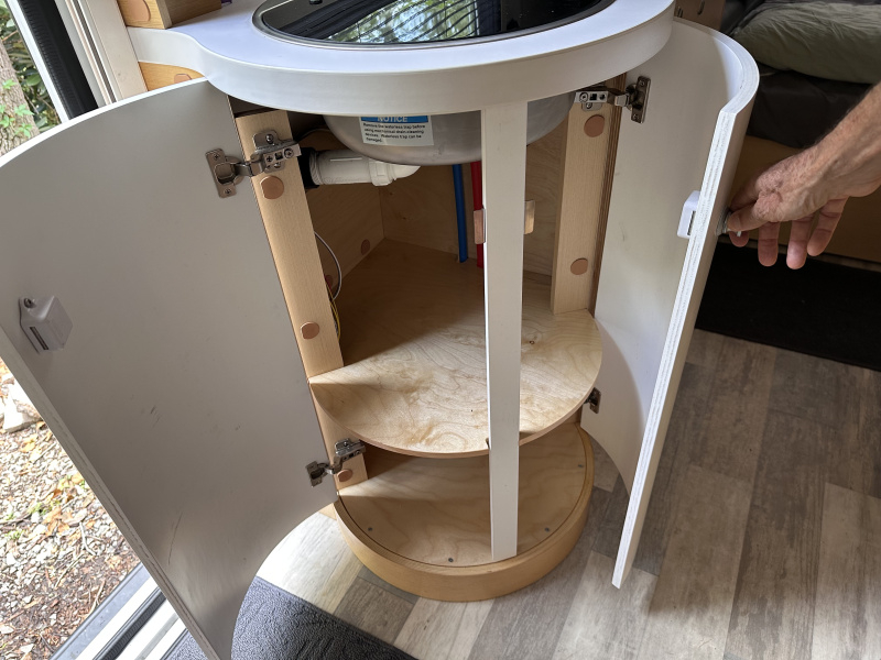

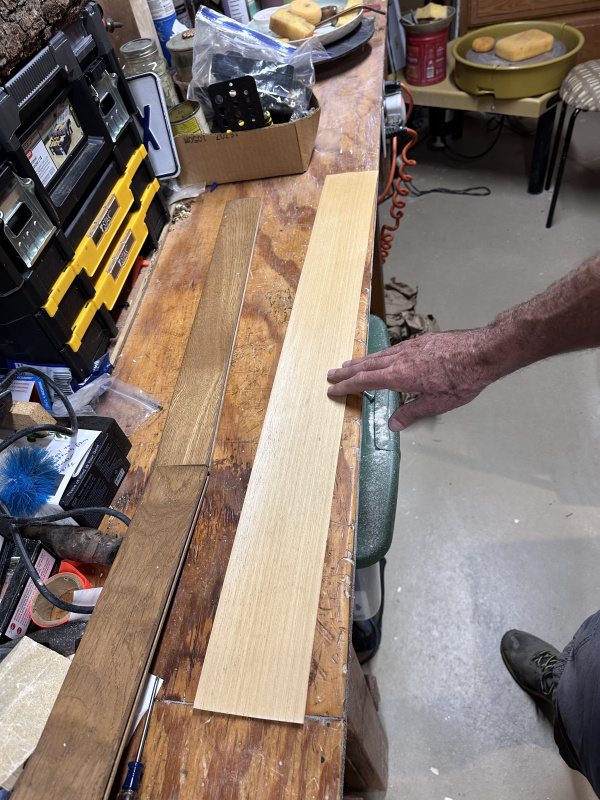

    We purchased a 2022 TAB 400 BD about 6 months ago and noticed the veneer of the rounded toe-kick piece in the kitchen was delaminating on the ends, like many here have also pointed out.
    Also, because of a mistake on my part (accidentally leaving bathroom faucet slightly on - filled grey tank and ran over onto the floor - yikes, you never want to return to your camper and notice water dripping under the door!) That contributed to an almost complete delamination.

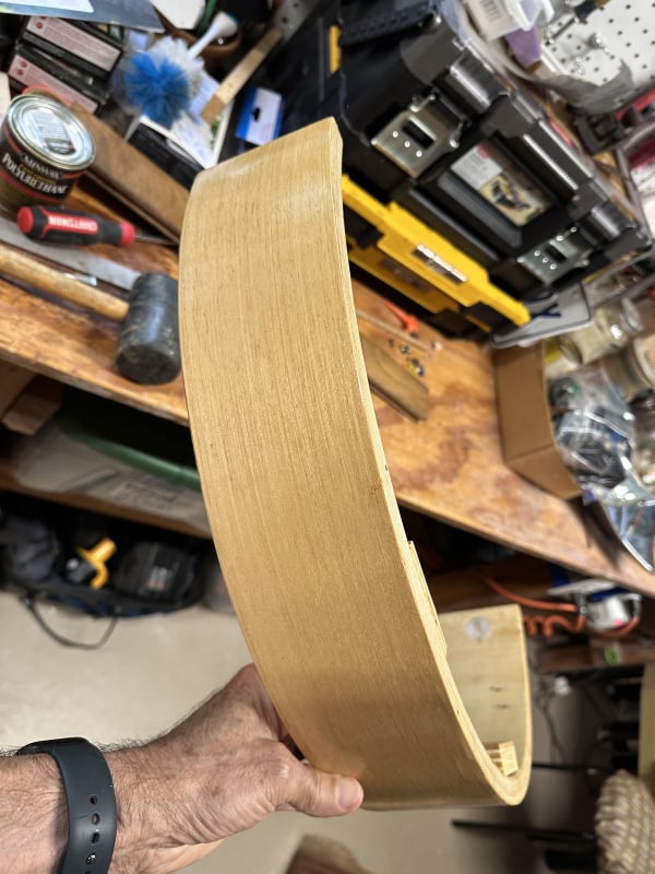

    Once I returned home I removed what was left of the veneer (previous owner had used some type of foam adhesive that left it uneven) and then removed the rounded plywood toe-kick piece.  I've tried to include photos of stages of this process but unfortunately not in correct order and please forgive the excess number, just trying to get as much in.

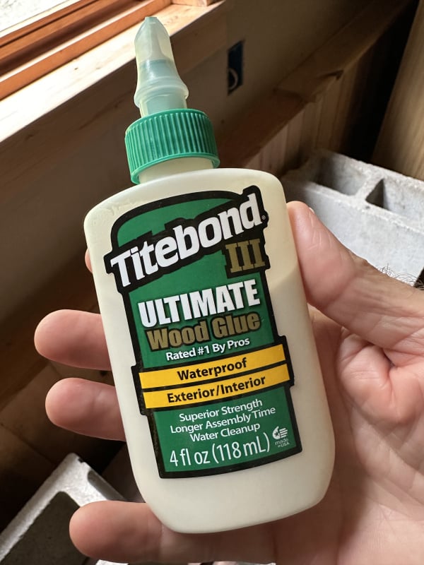

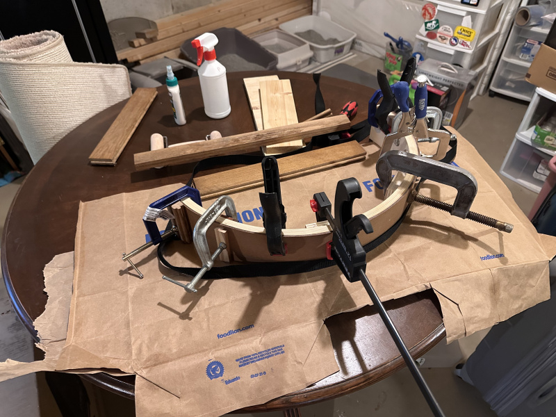

    I cleaned up each piece and sanded them down. I contacted Nucamp about adhesives (and spent waaaay to much time investigating) but they recommended a PVA like TiteBond 3, which is also waterproof.
    Made sure I had plenty of clamps and cut a piece of melamine the same size as the veneer to place over when gluing and act to distribute the pressure, and left clamped for 24hrs.  I then unclamped and cleaned up excess glue then applied 2 coats of polyurethane.
    Getting it all back together can be tricky - make sure you using the correct screws and original holes.  I also put a small bead of silicone caulk around bottom next to floor to keep any floor water from seeping underneath.  It came together pretty well and happy with the results. The polyurethane should also help to protect from water damage. Hope it lasts for the duration, wouldn't want to do this again.
