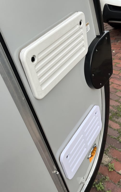

    Has anybody found a way to install a vent cover for the Norcold Frig? There are 2 vents (same size of approximately 15”x 8”) with white plastic covers, on the passenger sidewall, just in front of the door. Lost one on the interstate, and used cardboard and duct tape as temporary fix (removing when parked and refrigerator on). I’ve been told the part number is 638406PW BUT NuCamp says no longer available, and no dealers I’ve contacted have them either. Any one else come up with a creative solution? Sheet metal? I’d post a picture for info but haven’t figured that out on this site yet.  Thank you.
    2018 320s. Tow vehicle 2011 Nissan Frontier, 2WD, 6 cyl, tonneau cover on bed.

    2018 320s lost one of our vents on our drive home from dealer doing other maintenance.  Dealer can’t find any, I’ve scoured the internet and…. Nothing.  Currently using a home vent cover (metal) secured w zip ties.  I must say after 3000 miles w this setup, I’m pretty happy w it.

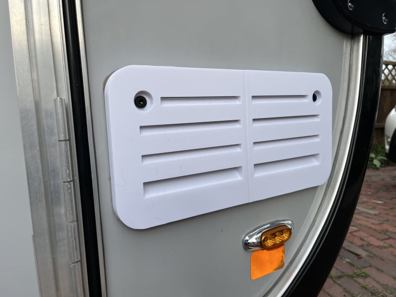

    Hi! Im new here, and I recently reversed engineered the vent cover (for a 2018 NuCamp T@B 320 S) and 3D printed a test and it works great!
    If you're interested please let me know.
    The cover needs to be printed in 2 pieces, and glued together due to size limitations of my 3D printer.
    I can also print these in black. If you want a different color, let me know
    Heres what I would charge:
    Labor/Materials = $80 (+Shipping)
    (Hardware included)
