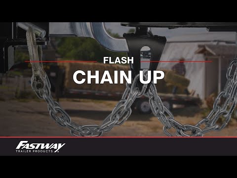

    I got this item from Camping World for my chains - it was inexpensive.
    Chain-up single ball mount
    https://www.youtube.com/watch?v=jD1vzJTr_0s

    Then I am doing it right, I was hoping that when the jaw was locked all was good but wasn't sure. Well thats one less thing to worry about. Mickietucs, I think I will get one of those chain-ups, I don't like having to twist the chain it looks bad. PXLated, the problem with the sparks is you cant see them while driving, what good is that?

    I twist my chains up and attach them to the receiver rings.  That solves any rubbing issues and eliminates any worries therein.   ;)
    Mike, I do the same. The video claims it can weaken the chains ad could be illegal. Anyone aware of the validity of those claims?
