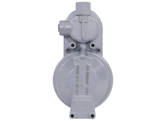

    @CatDaddy I just replaced my front tub with one from Sea Biscuit Metal Designs and lo and behold of course now my pigtail doesn't reach, so... while ordering a new longer pigtail I decided to look for a new regulator while I'm at it. I haven't taken the plastic cover off of my existing one, but will do later and will double check the number before I order. This is what I found on etrailer.com They have the GR-9950XF model which has a higher flow rate than the GR-9950 regulator so you might want to change it out. They have them sold and listed under JR Products so the part numbers are different but the pic on the site shows the Fairview part number on it. See pic below and here's a link to it on etrailer.
    Thanks! The original regulator in my 2022 NuCamp 320S Boondock was a Fairview GR-9950XF.  I believe the "XF" designates "Excess Flow" meaning that it has an excess flow prevention device as does the pigtail between the tank and regulator.
