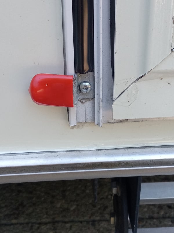

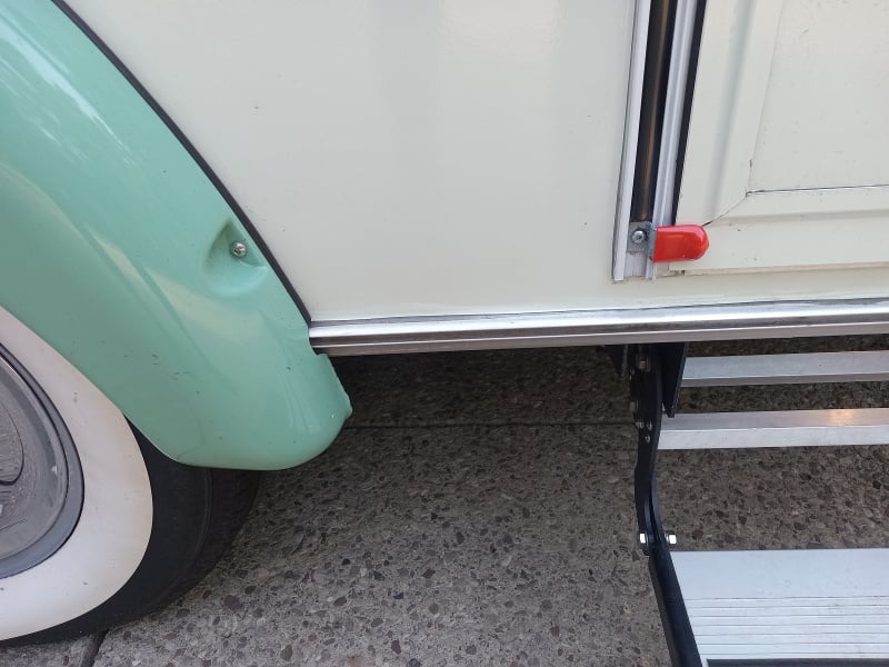

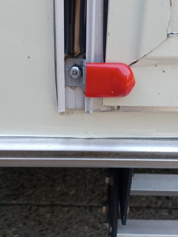

On a trip this Spring, after 7 hours driving through the rain the door towel was soaked beyond capacity. Something needed to be done.
I've considered a dead bolt of some type in the bottom corner to tie the door to the frame and prevent the seal separation during travel. My quick test of this idea is a simple "Z" shaped clip screwed in the frame channel and pressing against the bottom corner of the door. I flip it rearward when parked to keep track of it. The red rubber cap protects the door finish.
It certainly prevents the seal separation discussed above. So far it is untested on the road because of good weather conditions while traveling. If it solves the leaking issue I'll consider a nice dead bolt installation.
