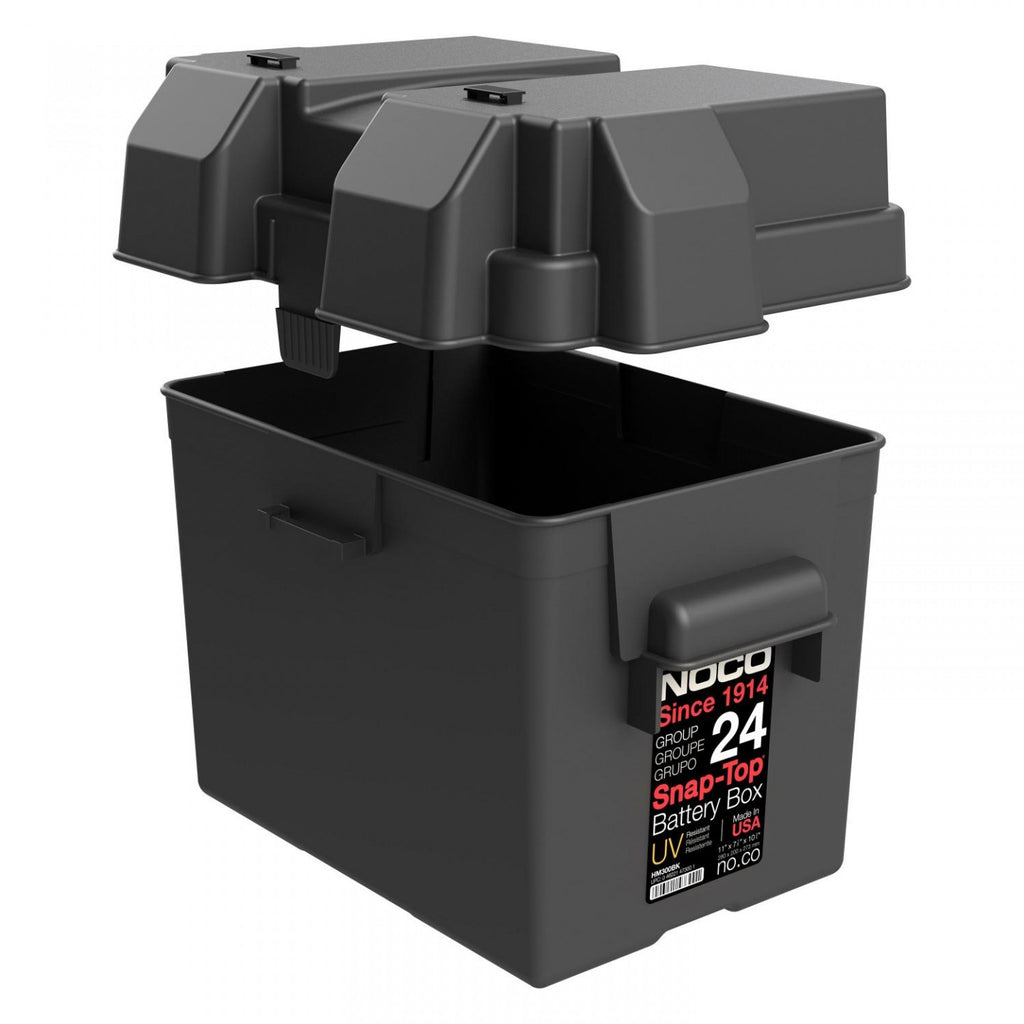

Manual says check breaker in battery tub. THE BATTERY BOX WONT OPEN. I have pushed the tabs, I have pulled the tabs, I have looked for yt explanations. Short of ripping it off I don't know what to do.

Pictures of the NOCO 24 group battery box attached.

These battery boxes can be a bear to open. You have to push really hard on the tab on the side and often you can't get both to release at the same time. Wedging a flat blade screwdriver can help.
Ok, got into the battery.

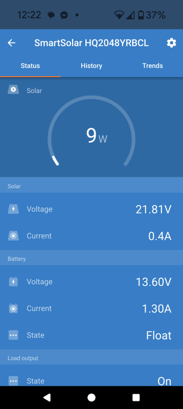

I will attach screen shots of the victron and photo of
the two battery connector thingies that might have breakers. But not sure how shore power would trip battery breaker.
