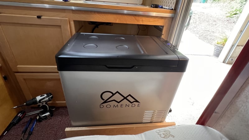

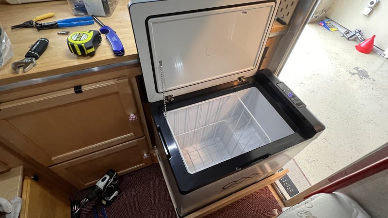

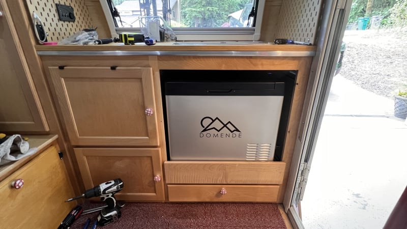

GIFTED. FREE! Original Norcold 3163LGH26R 3-way Refrigerator. Worked well. Removed to replace with chest cooler. Wired with external cooling fans and thermostat control.

How are you liking the Domende? After almost five full season, ours still works the same as when we installed it. Either great minds think alike or our fridge mod was your inspiration.
