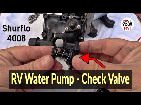

There is a check valve in the pump to prevent the backflow you describe. It is possible the high pressure event you describe has caused the valve to stick.0
Thank you. This pump is a ShurFlo 105-003. In searching for this valve, is this check valve internal to the pump, or external in the pipe from the pump? Not clear yet.T@B CS 2008
There are a lot of posts on pump repair. The check valve is part of the pump. Look over this thread.This is a video about it. Not sure if it exactly pertains to your pump, however.This appears to be a repair manual for that version of pump.
Thank you, this is very helpful. The link for my pump prompted my question as its diagram indicated the check valve was external. I believe I have another problem with this pump and I'll disassemble it soon to investigate it further.T@B CS 2008
https://www.youtube.com/watch?v=SKvzYoTs4J0
