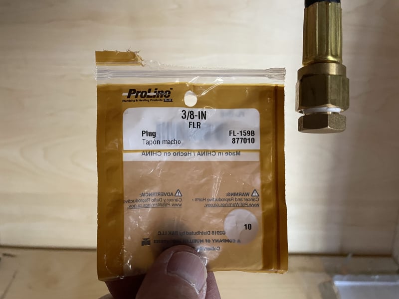

@Jay_and_Kat, in 2022 I replaced our 3-way Norcold with a 2-way Isotherm in our 2019 320 S Boondock Lite. I (like others) had to do some minor modifications to the exterior of the cabinet (e.g., venting), but installing the refrigerator itself was pretty simple. It slid right into the cabinet.
I opted to cap off the Norcold refrigerator's propane hose fitting. I attached a plastic electrical cable clamp around the propane hose and secured the clamp with a screw to the interior side of the refrigerator cabinet.

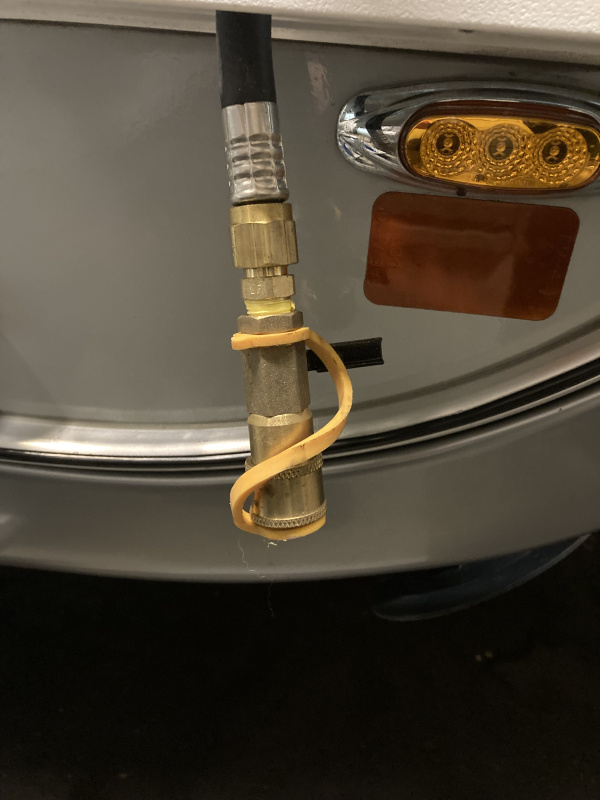

@AnOldUR we JUST this year bought a Blackstone and have used the external hookup on the back of our camper.
@Bayliss so it looks like to cap off the hose, at least in the 320 (and I wouldn't expect the 400 to a lot different) it's just a brass screw-in cap and some teflon tape? That'd be easy enough, this might be a project I'll tackle myself.----------------------------------------------------------

@Jay_and_Kat, "yes," that is all that is necessary, plus making the electrical connections, which is also easy. The only other factor to consider is air flow as described in the manufacturer's installation instructions, but that should not be an issue for you.
P.S. I'm not sure why I used white Teflon tape (at least it appears that is what I did), but you should use yellow tape recommended for gas lines connections. However, since the cap/plug is a "flare fitting", tape is not necessary (because the fitting creates a seal through the metal-to-metal contact.) If you do decide to use yellow Teflon tape, probably once around the threads (for extra sealing) is sufficient. You don't want too much.2019 T@B 320 S Boondock Lite ~ 2025 Toyota Tundra CrewMax 4x4
