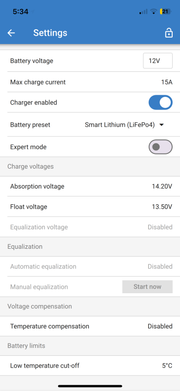

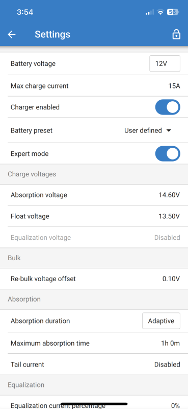

    Show us the settings page for your Victron solar controller.  Find  your battery manual, and lets make sure your settings in the Victron are correct for lithium battery charging.
    This Battleborn page has a guide on how to use the "Expert" mode in the Victron to get the settings correct.  Use your specific battery settings for the various voltages.  (They won't differ by much).

    Attached are my Victron solar controller settings.  I don't recall getting a manual for the Aolithium batteries and their website is down because the company seems to be out of that business now.  I can try getting that information from other sources though if there are specific parameters in question.

    @themcgillcrew I would, at the very least, go through the procedure for doing the "expert mode" settings from the Battleborn page.  There are very few differences in lithium charging parameters.  That "Smart Lithium" setting on the Victron setup page is designed for Victron's "Smart Lithium"...whatever that means.

    I updated my Victron controller with the parameters from the Battleborn page but little changed unfortunately.  It switched to bulk initially but soon returned to float.  The solar controller is still seeing the batteries as fully charged (13.5V) while the BMS has them at 73% (13.11V).  I'll continue my research but would appreciate any other thoughts.

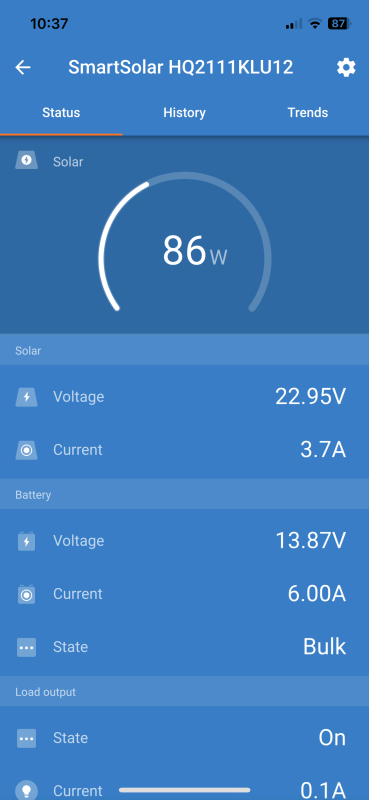

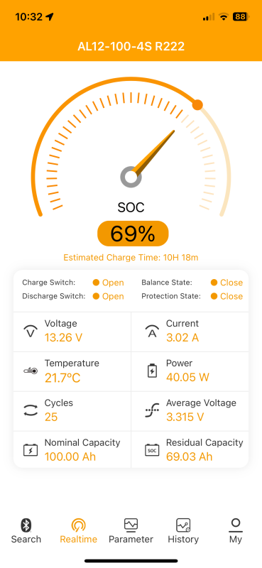

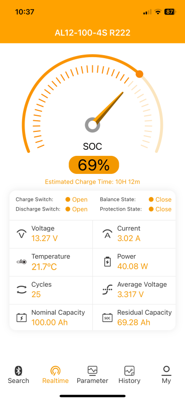

    I put a voltmeter on the batteries and both were at 13.18V (about 70%) so it would seem the BMS is correctly reporting the state of charge.

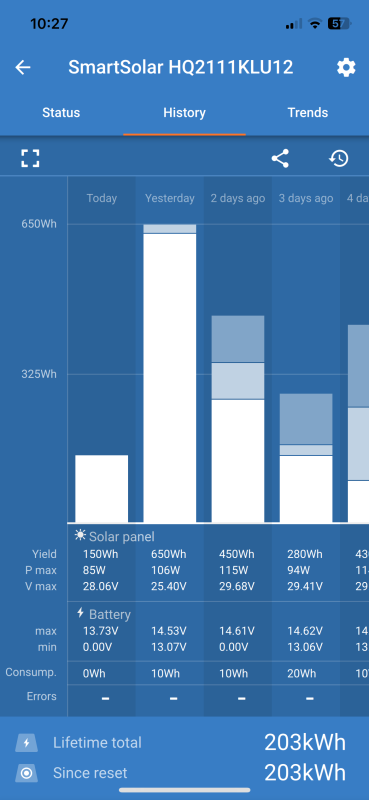

    I went out in the bright sunshine again this morning and found the solar controller reporting the battery voltage as 13.86V (about 100%) and again stuck in absorption mode.  I then disabled the solar controller for about 10 seconds then re-enabled it.  Interestingly, the solar controller went to bulk mode.
    Today I'll try @Bayliss's idea and depower the controller to try the old stop/start solution.  I've also been in touch with the Victron supplier for nuCamp and started a thread with them.  I'll report back here if anything comes of that as well.
    SC stuck in absorption mode
    BMS sitting at 70%
    SC in bulk mode after disable/reenable
    BMS after disable/reenabling SC
    SC charge history showing periods of bulk charging mode
    I still don't know why the SC sees the batteries as full when the BMS says they're not.  Also, I don't understand why disabling the SC then re-enabling it flips the SC to bulk mode for a while, yet not enough to fully charge the batteries.

    Attached are my Victron solar controller settings…
    Absorption voltage: 14.20
    I suspected that this isn’t enough, and prowled around for mentions of Aolithium. I found a video which happened to show a page of its printed manual:
    It’s uncertain whether it is the same model as yours, so I suggest raising the charge setting to 14.4v, which is common for many LFP batteries.
    It’s also possible that its internal BMS is flakey; I found a few discussions of dealing with warranty returns. (No surprise that they seem to be out of business)

    The SC and BMS agree on the rested battery SOC.  There's plenty of solar coming to the SC and the charge state is bulk yet the SC says the batteries are fully charged which they are not.
    The batteries seem to be accepting only a couple amps so I'm not making as much progress as I'd expected.  I'm certain that just this spring the solar was topping off our batteries without problem so I don't know what has changed since.

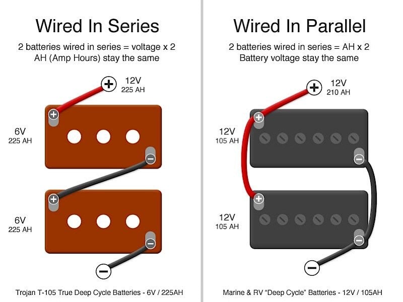

    Are your batteries wired in "series" or "parallel."  The reason I ask is because you most likely had the two 6V batteries wired in series, which allows the two 6V batteries to become 12V.  Since you now have two 12V batteries, you want to wire them in parallel so that they remain at 12V/200Ah (rather than 24V/100 Ah.)  You can read more about the differences via a Google search.
    I'm just wondering if maybe that could the problem, because your solar controller and BMS are set for 12V, but your batteries might be wired to create 24V.  Just a thought, because I am running out of ideas to share with you.
    Also, I may have missed it in your comments, but did you charge each of the batteries to 100% with a separate lithium-capable charger?  If not, do that before reconnecting them to the trailer solar/BMS.  You can then do a manual reset to 100% synchronization to see how things go from there.
    Finally, have you received any helpful input from nuCamp's Victron supplier?  Just curious.
    Below is a depiction of the difference between series and parallel wiring, BUT NOTE: Although the wiring is accurately depicted, there is a
    typographical error in the text below the "Wired in Parallel" heading.  The text should read “2 batteries wired in parallel . . . .”

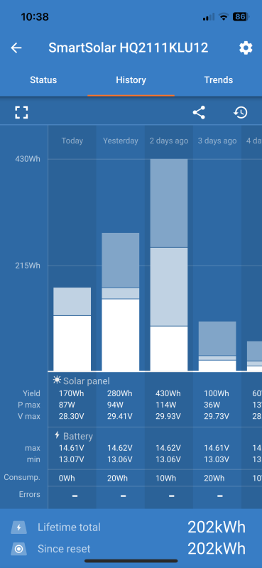

    The bolded text misinterprets the solar charger’s voltage during active charging. It’s only the resting voltage which can show you the S.O.C. While charging — pushing current into the battery— the SC must drive it at a higher voltage that the current state of the battery: otherwise the current won’t “go in”.
    You’ll notice that the charging graph of last few days shows that the max voltage reached 14.6v on the occasions that it switched to “float”. That’s a strong indicator that a LiFePO4 battery is full.
    Re: the battery “accepting only a couple amps”: that’s probably just the amount of power that the panel can provide at the time. Solar panels only generate their nameplate power when 1) flat rather than curved, and 2) pointed perpendicular to the sun on a clear day.  The history graph shows a  peak of 115w of generation a few days ago, so charging at 85w now is reasonable.
    It’s still possible that something is broken, but I’m not seeing any evidence yet.

    Thanks again @Bayliss. Yes, the two Aolithiums are 12v wired in parallel and I did charge both to 100% before installing them.  The Victron supplier responded to me promptly at first but seemed to be talking about a shunt for some reason. Nothing since.

    .. So I still don’t understand why the SC doesn’t run more amps into the batteries in bulk mode.
    It is likely that the solar panel isn’t providing more than 85w or so of power, due to curvature and non-optimal sunniness.
    The most recent Victron graph shows that the batteries went to float 2 days ago. Do you remember what the aolithium app showed at the time?  Would you leave it on the charger for a day or two, until the batteries go to “float” again (probably resulting in a Victron max voltage of 14.6), then check the BMS’s app again?

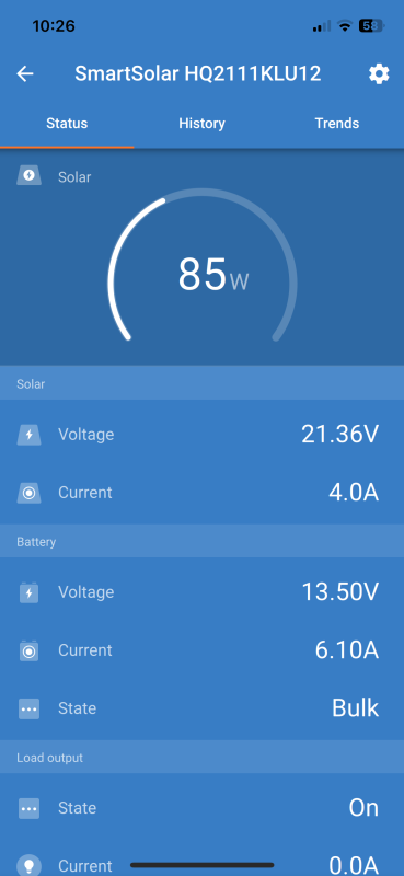

    The controller is only going to send as power as is being produced by the panel to the battery. If you had a solar panel producing 180w of course the current (amps) to the battery would be higher.
    In your screenshot, the panel is producing 85w at 21.36v and the controller converts the voltage to 13.5v for the battery input, which results in 6.1A (82.35w). There just isn't any more power for the controller to send to the battery.

    The controller should stay in "bulk" mode until the battery is nearly completely charged. I think the Victron manual discusses the parameters that must be met for the controller to shift from Bulk to Absorption and then Float.
    The monitor that's built into your battery shows that the battery is down about 32.28aH (100aH - 67.72aH) so at ~6A it would take about 5hrs to recharge the battery (and I think you have two of them).

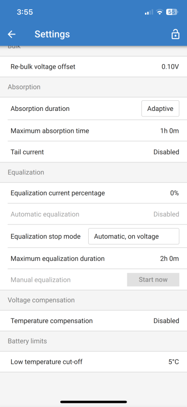

    Thanks @ckjs.  I've been playing around with the SC settings including an absorption voltage of 14.6V but it's still reading the battery voltage too high.  See below.
    Try changing your absorption duration to fixed. 1hr.
