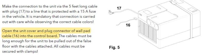

The AIr8 Installation Guide shows/states the unit requires 120VAC only power input.Control Panel VDC is created by the Air8 main PCB.
This is different from the Alde Heat System as the Adle includes a propane operation mode so the WFCO Power Center does have a 12VDC Fuse to allow the Alde electrical items to operate in propane (fuel source) mode.
From Installation guide 'Wiring" :

Okay, I suggest the actual wiring/connections be traced as
Air8 documentation indicates no 12VDC requirement and nüCamp DC Fuse Panel Labels are known to be incorrect over many production years . . .'18 320 S, pitched axle, 3020HE; PNW based
