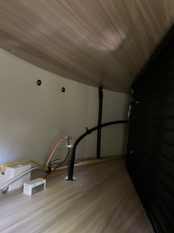

Looked behind the refrigerator in our new 2025 Tab 360 - saw no fan - see picture - should there be a fan?

    Is it an Isotherm refrigerator? Is there a vent above the door or in the countertop?

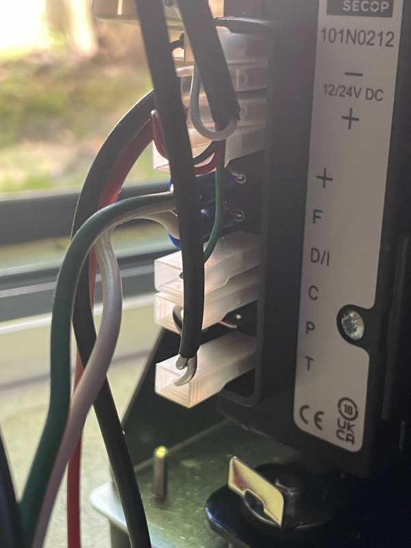

    My 360 doesn't have a fan, either.  I'm working on adding one myself.  I've attached photos of the space behind the refrigerator and a close up of the refrigerator control panel.  I can't figure out where the green and white wires are that go in the + and F terminals behind the frig - per the Service Bulletin issued to correct the mis-wiring problem.  I'm beginning to think I should just buy a fan and have it installed so I can turn it on and off - not through the refrigerator.  I certainly don't want the fan to trip a circuit protector.

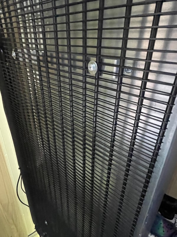

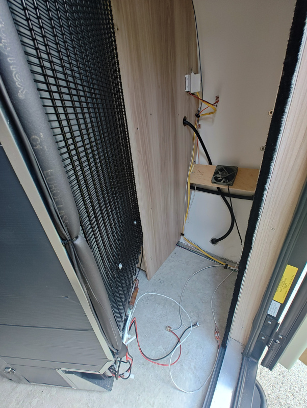

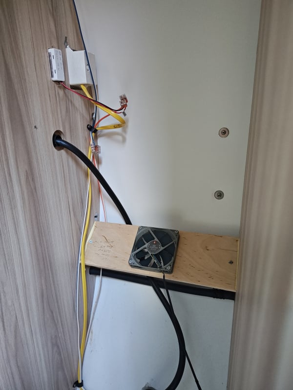

    Hi @LauraC
    I was able to get some photos.
    The fan (just a big computer fan) has two wires.  The black one goes to a white wire which connects to the F position on the circuit board and the red wire from the fan   goes to the green wire which connects to the + on the circuit board.
    Below you can see the condensor coil which goes the entire height of the fridge.  When the compressor runs, those coils get hot as they should as they are removing heat from the compressed refrigerate.  Having a fan certainly will help push the heat up and out the vent at the top and into the cabin area and help it run better.    I could feel the air get very warm, being pushed out by the fan when I started the fridge up.  Any good handyman or person can install.  Does not need to be a RV place.
    I tried to look down the opening but could not get far enough in to see down....I need to bike more to squeeze in :)

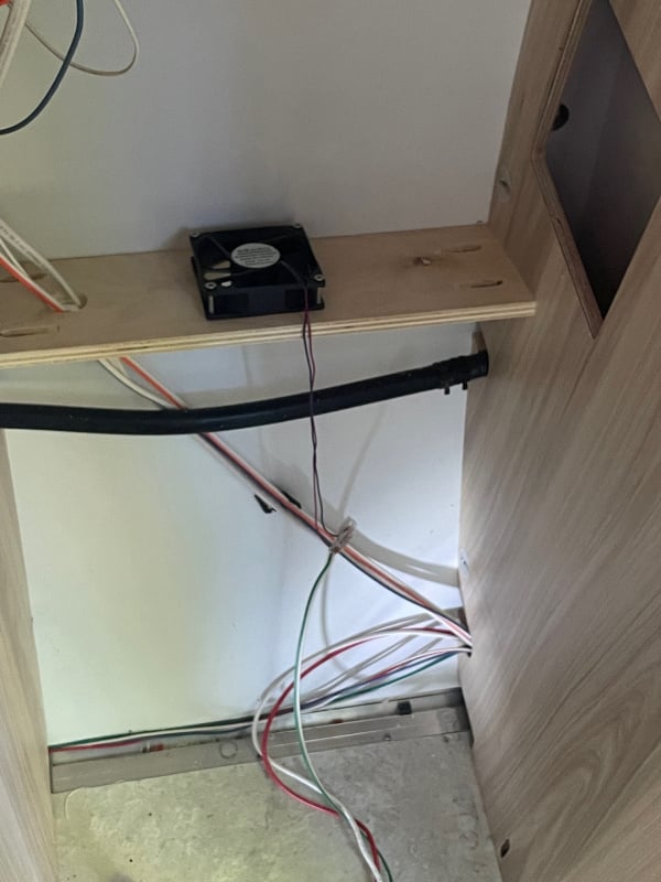

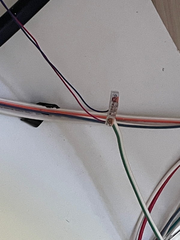

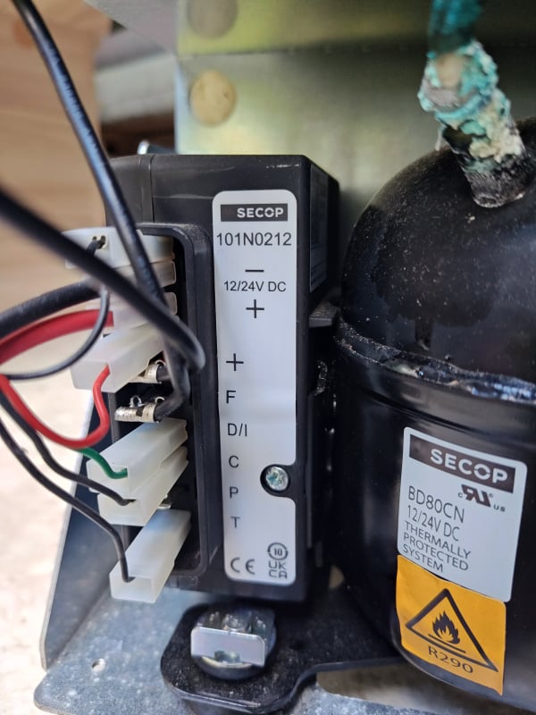

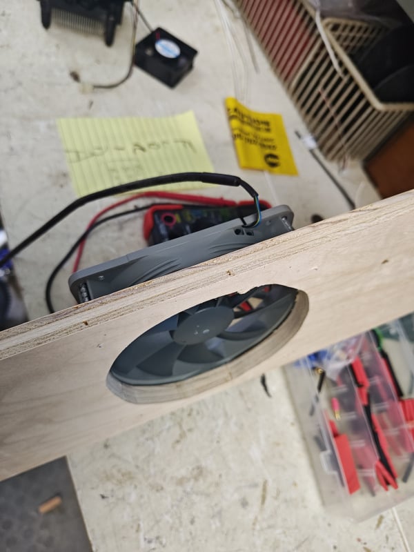

    I have an early build 360. The isotherm 140 fridge works really well, no issues. However I have added a fan that comes on when the compressor runs to enhance the convective air pattern, drawing air from underneath up, behind, and out the top of the cabinet. In Florida this spring we did have a couple of days where the front of the trailer was in hot sun during the afternoon. The fridge kept up fine but it ran more than usual because that cavity was getting external heat. So I don't know if this mod was required necessarily but it seems beneficial to prolong the life of the refrigerator and reduce stress on the batteries. I used a good quality, quiet 120 mm computer fan. Those are four wire fans for pwm control but you can just use the black for negative and the yellow wire for positive and ignore the other two. (@yoshi_tab your pictures were very helpful.) As describe above the black wire goes to the F (fan) terminal on the control board on the back. The yellow wire goes to the "+" terminal. I mounted the fan about 18 inches off the floor at a 45° angle. It runs at full speed when the compressor comes on and uses about 0.1 amp.
