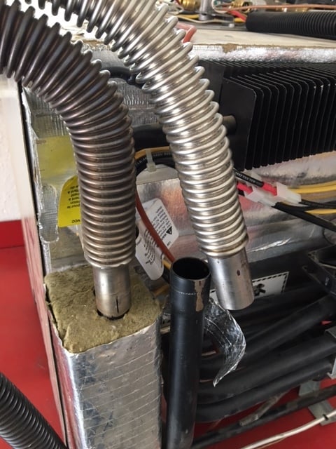

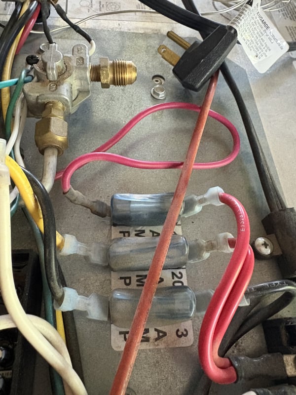

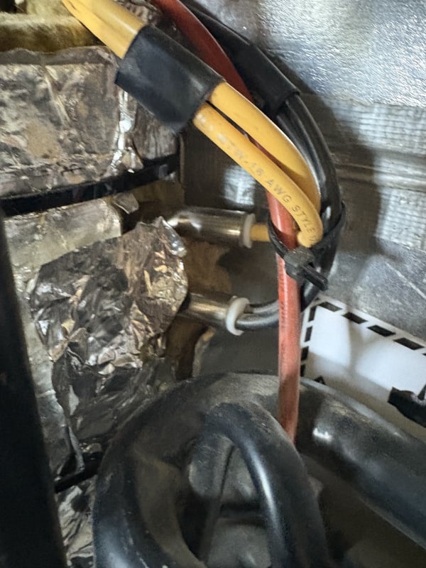

I found some old pictures and happen to have my 3163 on a bench, so i checked and the DC heater element (on mine, YRMV) has the yellow leads, and the AC element has the black leads, which might be useful in addition to what @rcarlson1957 said. I took a picture of the two fuses, the 3amp is for the 120V, and the 20amp is for the 12V, see attached.Hopefully it is just a bad fuse, but if you do end up needing to replace the heating element, and have to pull the frig, i have an unedited video showing the location of the element and the insulation that comes off. I wasn't able to attach it here, maybe it is too large. @Sharon_is_SAM, can I upload a video of 9.3meg somewhere?Your method may vary, but i removed the burner box to get the vent pipe out of the way, in order to access the insulation. In the attached single picture, you can just see the slit that exists in the insulation, and i think what i'm trying to say in the video is that I slit the foil to access the 12V and 120V heating elements. In hindsight, now that i know what the insides look like, it might be possible to remove the two upper stacks (halfway done in the picture), and then slide up the insulation block and the two heating elements at the same time, without cutting the foil. Those two elements are not easy to remove from their pipes, which makes sense from a heat transfer point of view. That insulation blanket is obviously important, and i now have to hold mine together with zip ties. So if you can keep it intact that would be best. And as shown the DC heater element is ON TOP of the AC heater element, so you'll have to remove both.I'll also suggest if you do purchase the heater element, there are two different elements depending on your 3163 Serial Number (ask me how i know). Model and SN are located inside the frig on a tag (at least on mine it is). Below is an image of the SN split and the heating element needed based on the SN.
