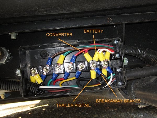

RCB said:AnOldUR. Thanks for the comments. What / how did you disconnect the charging from the tv ?
To isolate the trailer battery from the tow vehicle I disconnected the charge wire in the junction box behind the tub.
With the charge wire disconnected in our system, if the battery switch is off, the interior lights (or any 12V accessories) will not work even if connected to the tow vehicle. Without our mod being done, power from the tow vehicle's battery would be sent to the converter regardless of the battery switch being on of off. Newer vehicles have isolation relays, but with your trailers 7-pin connected, the engine running and the battery switch off, I believe you should still have 12V going to your trailers interior lights through the charge wire. Hopefully someone with more experience can determine why you're not getting power to your charge wire. As you said, it could be something as simple as a fuse.RCB said:I’ve turned the batt switch off and connected the tv and engine running and could not power any lights etc in the rv.

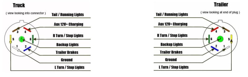

The TRAILER PIGTAIL goes to pin #4, Aux 12v + Charging
Reminder, your breakaway brakes will not work with the battery switch off. Always leave the switch on while towing.
