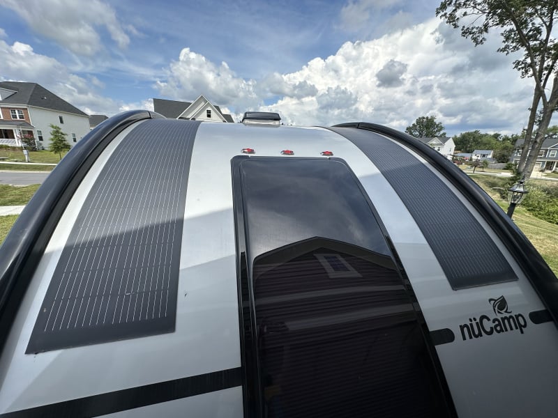

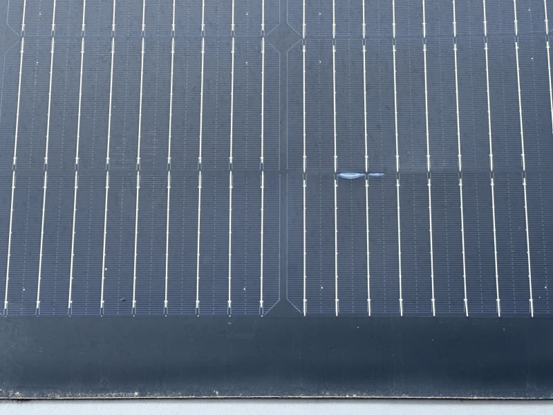

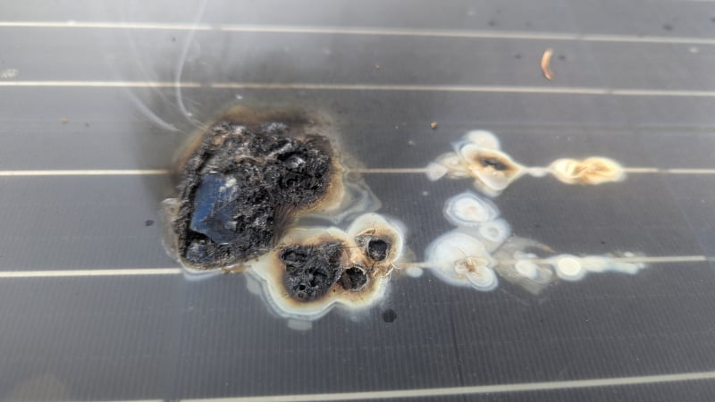

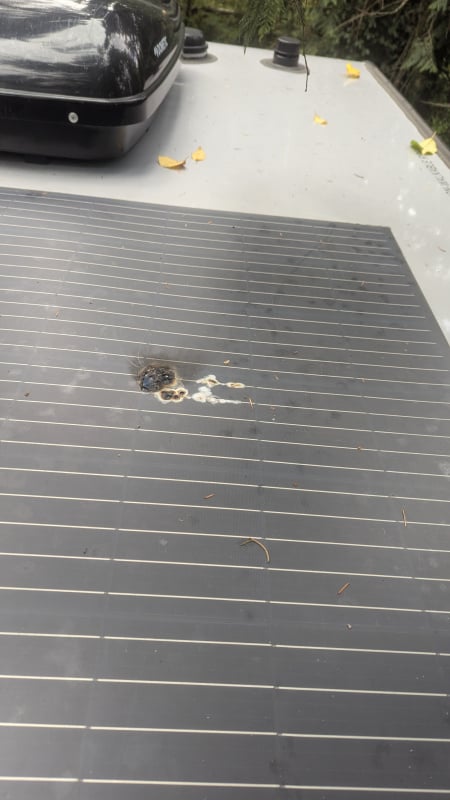

    Here are some photos from a 2024 400 and a Cirrus camper (year unknown).  Other owners have piped up and said they have the same things happening.  This is the Cirrus, hard to tell the scale here.
    The 2024 400

    We attended the first Sunflare talk at uCamp. To the best of my memory, the Sunflare rep said it was a misalignment on the assembly line that allowed a short circuit soon after the panel was fully connected and activated (as their press release above also seems to state).
    NuCamp rep said in their products it predominately affected a limited number of 2025 T@B 400s. She also said they believe they know which trailers were affected and most were still on dealer lots. Also, if you're battery has been installed awhile and the panel experienced no issues that you most likely don't have a panel from the defective run.

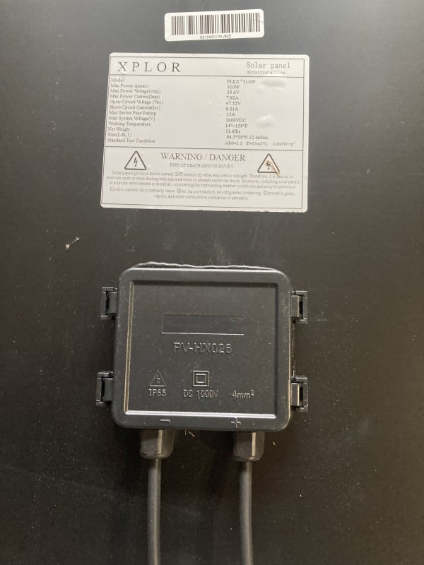

    That makes me wonder if Sunflare can tell you if your panels are from the bad lots by the serial number? I took a picture of the labeling on the back of my new panel before installing. There's a barcode and a number. I'll have to contact Sunflare to see if they have any information.

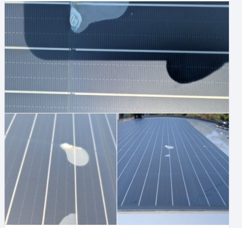

    I might have one of these on my tab 360 built last fall. I have been very disappointed with the performance of my two 190 watt panels, so this might explain my problem. Here are photos that show the issue that I am seeing. Look closely at the left-hand panel.

    Yes they are...in fact, the way it reads is that those are the main culprits...However at the uCamp Sunflair tech session, they said it was "mainly" in units built in 2025, so look at your manufacturing date. They did state emphatically, that if it was a bad panel, it would fail as soon as it was powered, leaving a noticable burn mark on the panel itself. So if yours are working, you should be fine.
    "We want to inform you of an issue identified in a small number of Sunflare flexible solar panels, specifically the 190 watt model, but also possibly in 180 watt and 310 watt models. In fewer than 2% of units shipped, we discovered that under certain conditions, electrical arcing may occur due to a slight internal misalignment during manufacturing. In rare cases, this could lead to visible damage or smoke from the solar panel."

    my solar performance has always been bad, so I suspect that I have always been limping along with only one panel.

    My two-panel system is working badly. Maybe the right one is still working and the left one is failing.

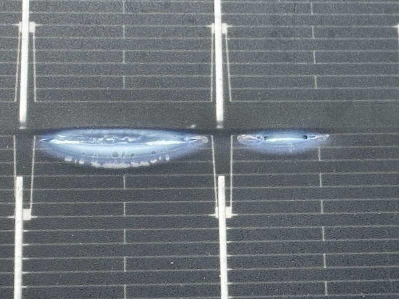

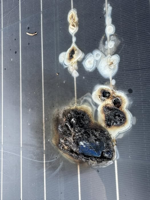

    These photos show the Solar Panel damage for a Cirrus 620 Manufactured August 2024.
    Close-up and full panel shots.
    NuCamp assures me that the damage will be covered under Warranty.
