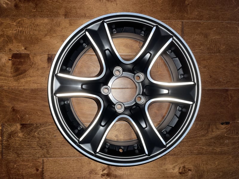

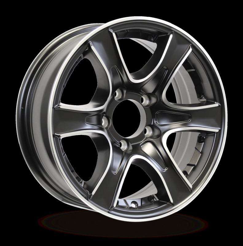

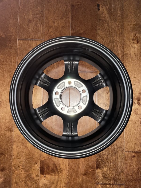

@Mcbret, I have the same Goodyear Endurance tires (ST225 75R15.) My 2019 320 S Boondock Lite has the 15" diameter wheels with a 6" width. 5 lug with the 4.5" spacing.
In July 2023, I purchased an identical replacement wheel from "TrailerSetGo" ( https://trailersetgo.com/meet-trailer-set-go ): Part #: PDTB55545BM Thoroughbred 15x5 5-4.5 Black Aluminum Trailer Wheel - - Matte Black. However, you will need to contact them to find out if they still sell them. The wheels are stamped "15X6.0J" (6” rim with standard RV “J” collar profile for the tire bead.)

Here are some pics for comparison:
Thanks Bayliss, That is exactly what I was looking for!! Take care...Karen, Bret & Banana Widdifield
