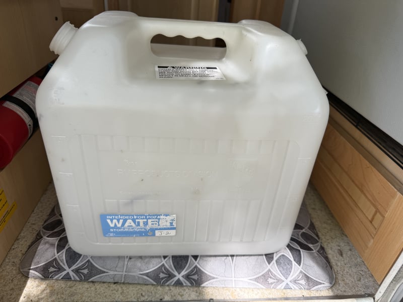

    Picture, it is the fill hole on the left that is missing the cap.

    Thanks @amelia2010tab.  Nice to finally see what it looks like.
    I did another Google search........ Google Search  Gallon Jerry Can Plastic Food Grade  See if anything there looks like it might work for a replacement water container.
    One thing I am not sure of is whether the smaller opening at the back end of your container is an air vent, or if a plastic tube fits in it.  But, if you search for "5 gallon/20 liter food grade plastic water jugs" or similar search words, you may find a good replacement container.  Also, search Amazon, Wal Mart, ebay, etc., using similar terms.  I did see lots of plastic jerry can caps online.  It is just a matter of matching the opening and thread size for your container.

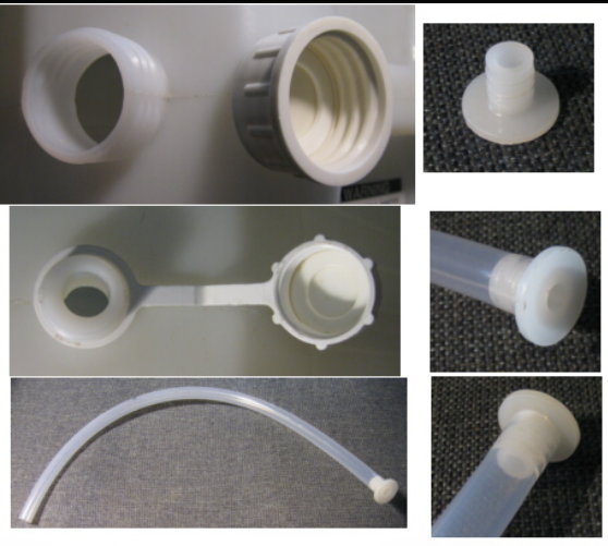

    This is a picture of the original Dutchman tank cap and dip tube.  This ultimately connects to the inlet of the pump.  Are you sure there isn't a tube coming from the pump with something like this on the end?  There is a hole in the cap for the tube and a gasket to seal it to a similar piece in the pump tube (top R corner).  My DM is long gone but I found this pic...

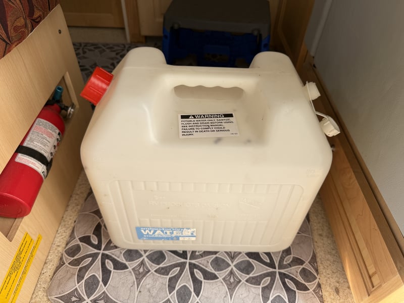

    1. Pic of can with new cap,
    The smaller cap with the tube is still there. See pic 2

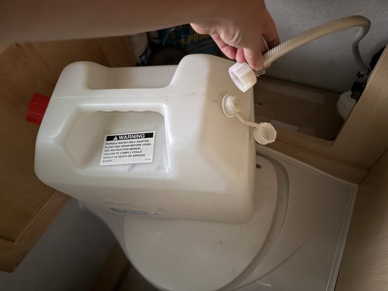

    2.
