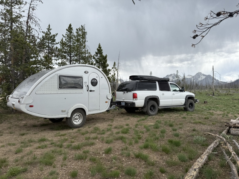

  • rzabel
    rzabel Member Posts: 33
    Grumpy_G said:
    Despite the marketing the rubber torsion axles are unsuitable for actually going off pavement. Even a bumpy paved road can get the trailer tires to bounce off the the ground. According to the axle data sheet the wheel has a mere 1.5" of upward travel at rated load.
    One member here ( @rzabel ) converted his trailer to Timbren independent rear suspension similar to what most "proper" off-road campers use. Details here: https://tab-rv.vanillacommunity.com/discussion/comment/214535
    We got to try out our upgrades earlier this summer with a month long trip fishing and camping in Idaho and Montana.  In addition to the increased clearance, the greatest benefit was how well it rode.  I tried putting shocks on the original axles/suspension and it really made no difference. The Timbrens rode as if I had very good shocks, dampening the big bumps.  The interior is all new and built to take some abuse too, so we were very happy to find everything in it's place when we arrived at a campsite, instead of on the floor as happened too many times before!  We didn't test it much, mostly just forest service roads, a few with ruts and washouts as can be expected, but it is so much better suited to that now.
    2008 Dutchman/Thor T@B T1
    1948 Spartan Manor
    2003 GMC Yukon XL 2500 TV
