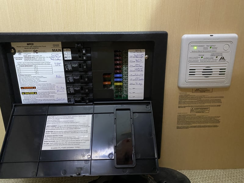

    When you open it the layout should be pretty straightforward. Here is what the 2019 400 looks like with door open.
    The Kitchen GFI  breaker is near the top on mine and is a 15 amp breaker. Typically having 2 appliances on that exceed 1,000 watts each  (about 8-9 amp draw each ) will add up to more than 15 amp current and trip the breaker

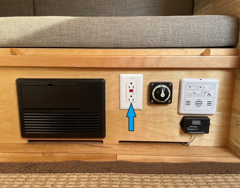

    @litchik63, although you mentioned "The GFI resetting it doesn't take care of getting the power back on," it is not clear if you are referring to the GFCI outlet (and whether you are referring to the trailer kitchen, or the kitchen inside your house.)
    I'm not familiar with its exact location in the 400.  The below photo is from my 2018 T@B 320 S, but all GFCI outlets are similar, so you should have little problem finding it.  Also, you may be plugged into a GFCI protected circuit at your house.  The actual GFCI outlet will be located at the beginning of that circuit and is protecting other outlets on the same circuit.  You should have one or more in your garage, outside outlets, kitchen, and bath areas (basically, anywhere that water is likely to be present.)
    Assuming that the circuit breaker protecting the GFCI outlet has not tripped, the outlet itself may have tripped and just needs to be reset.  Locate that outlet (or outlets if there are more than one involved) - - - SEE PHOTO BELOW - - and press the "RESET" button (white button below the red "TEST" button.)
    IMPORTANT:  A GFCI outlet will not reset unless it has power, so you definitely want to confirm that the GFCI circuit breaker in the trailer power center (as shown in the photo provided by @qhumberd), or your house circuit breaker panel, has not tripped.  Even if that breaker appears to not have tripped, flip it "off" and then back "on" to be sure.  As also mentioned, if you have too many items drawing power on the circuit, it may be overloaded, so unplug any items on that circuit before resetting the GFCI.
    If you have a multimeter, or outlet tester, you can also use one of those to test for power at the outlet.  Or, keep it simple, and plug a small appliance into the outlet, like a radio or fan, to see if there is power to the outlet, whether it is the GFCI outlet in your trailer, or the outlet you plugged into at your house.
